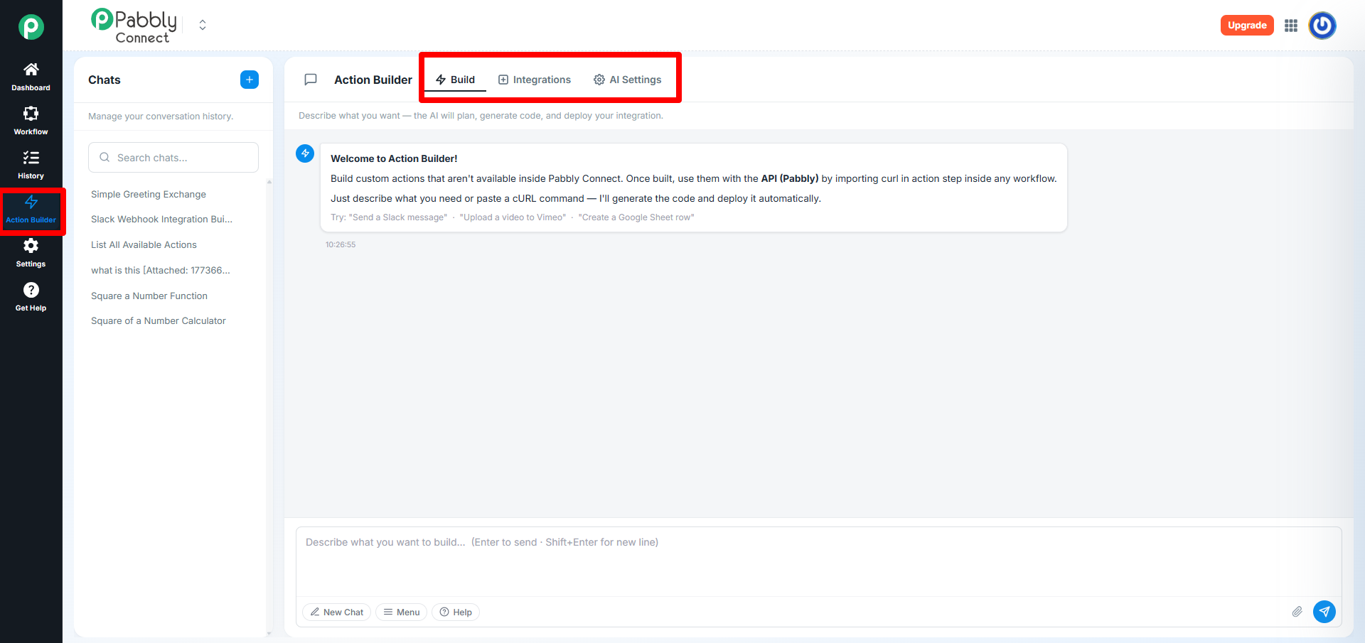

Step 1: Access Action Builder
1. Log in to your
Pabbly Connect account.
2. In the left sidebar, click on
Action Builder.
3. You will see the main dashboard with three tabs:
Build -- Chat with AI to create integrations
Integrations -- View and manage your deployed integrations
AI Settings -- Configure your AI provider

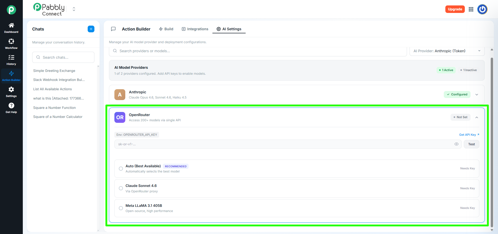

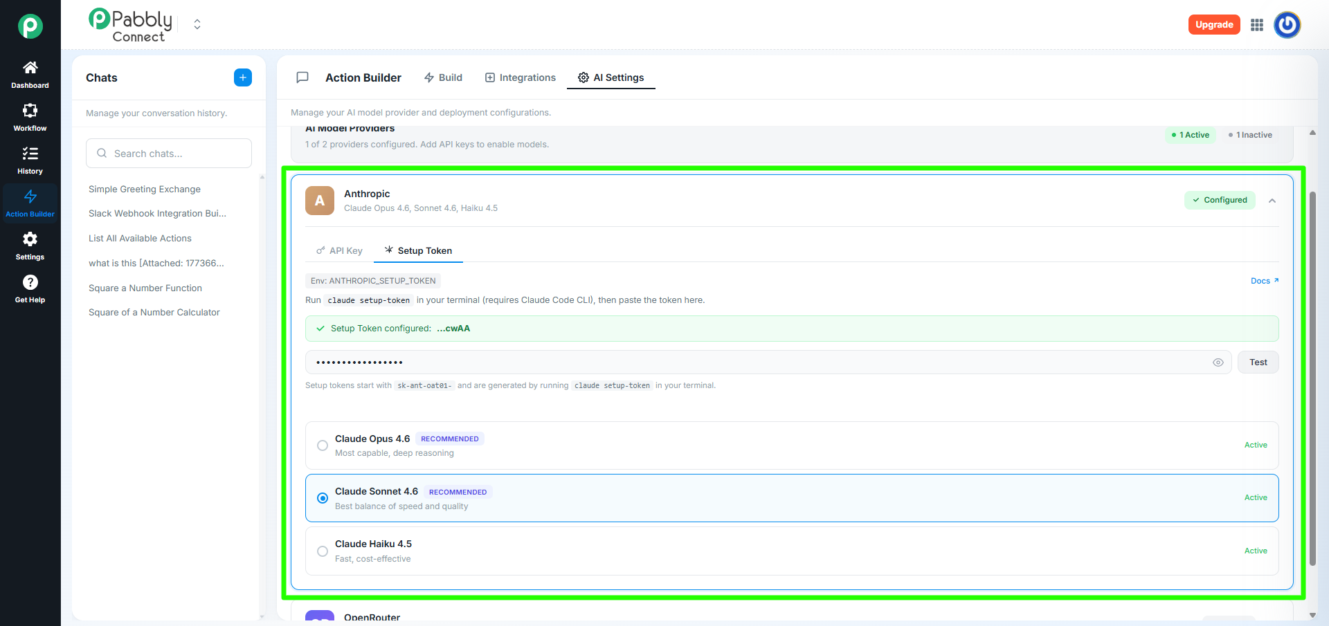

Step 2: Configure AI Settings (First-Time Only)
Before creating your first integration, you need to set up an AI provider.
1. Click the
AI Settings tab.

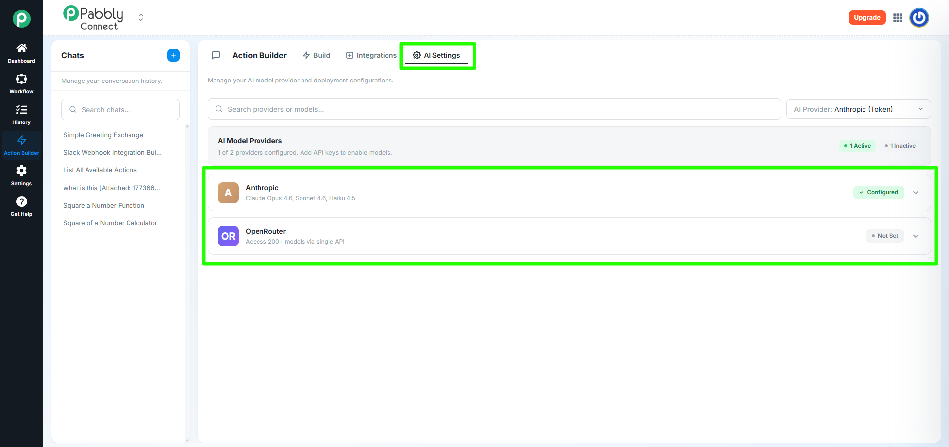

2. You will see two AI provider options:
Anthropic (Recommended) -- Claude Opus 4.6, Sonnet 4.6, Haiku 4.5
OpenRouter -- Access 200+ models via a single API
3. Expand the
Anthropic card by clicking on it.
4. Choose your authentication method:
API Key -- Get your key from
console.anthropic.com. It starts with
sk-ant-api03-...
Setup Token -- Run
claude setup-token in your terminal and paste the generated token.
5. Paste your key/token in the input field.
6. Click
Test to verify the key works.
7. Select your preferred AI model (
Claude Sonnet 4.6 is recommended).
Important: Your API key is stored securely and never exposed in the generated code or logs.

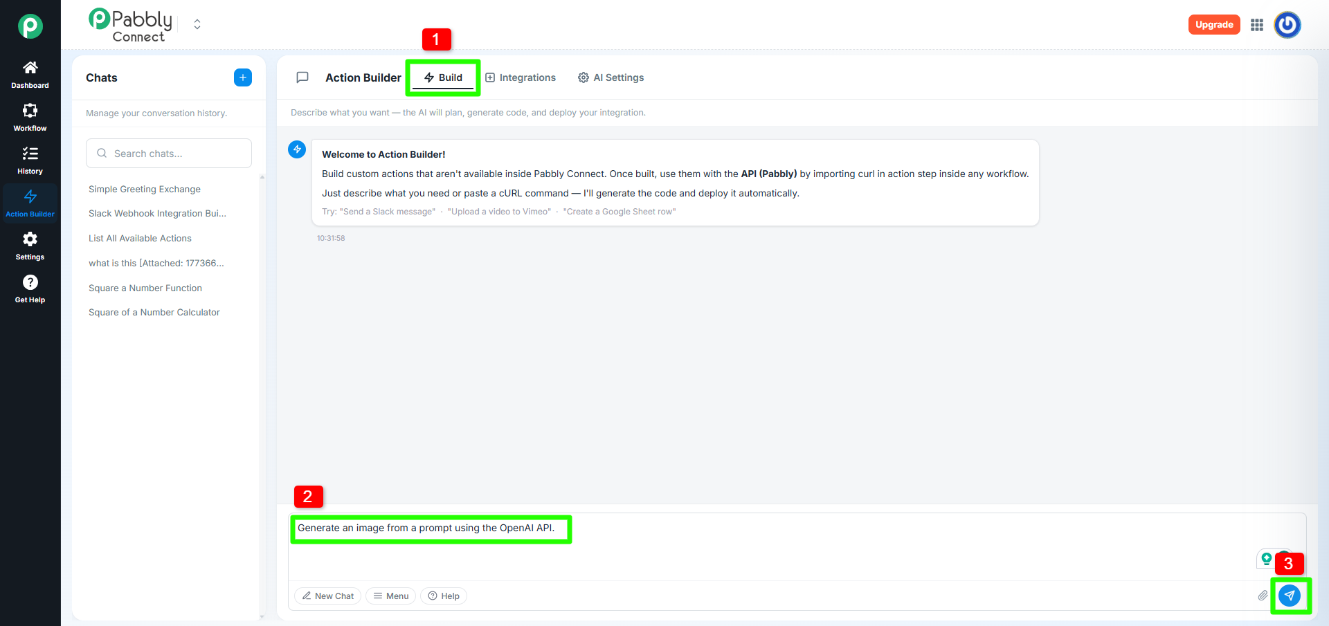

Step 3: Describe What You Want to Build
1. Go to the
Build tab.
2. In the chat input at the bottom, describe what you want to build. Be specific about:
- Which external API or service to use
- What action(s) the integration should perform
- What input parameters it needs
Example prompts:
- "Send a Slack message to a channel using a webhook URL"
- "Generate an image from a text prompt using OpenAI DALL-E 3"
- "Create a new row in Google Sheets using the Google Sheets API"
- "Send an SMS using Twilio API"
- "Upload a video to Vimeo from a URL"
3. Press
Enter to send your message.

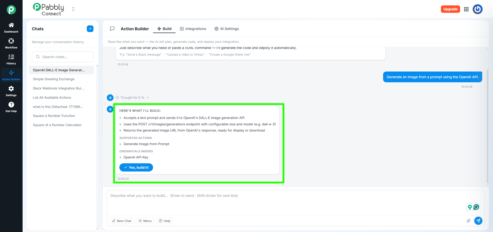

Step 4: Review the AI Plan
After you send your description, the AI will present a
plan card showing:
- What it will build -- 2-3 bullet points describing the integration
- Supported actions -- The API actions it will create
- Credentials needed -- API keys, tokens, or webhook URLs required
If the plan looks correct:
Click
Yes, build it! to proceed.
If you want changes:
Type your modification in the chat (e.g., "also add a delete action").

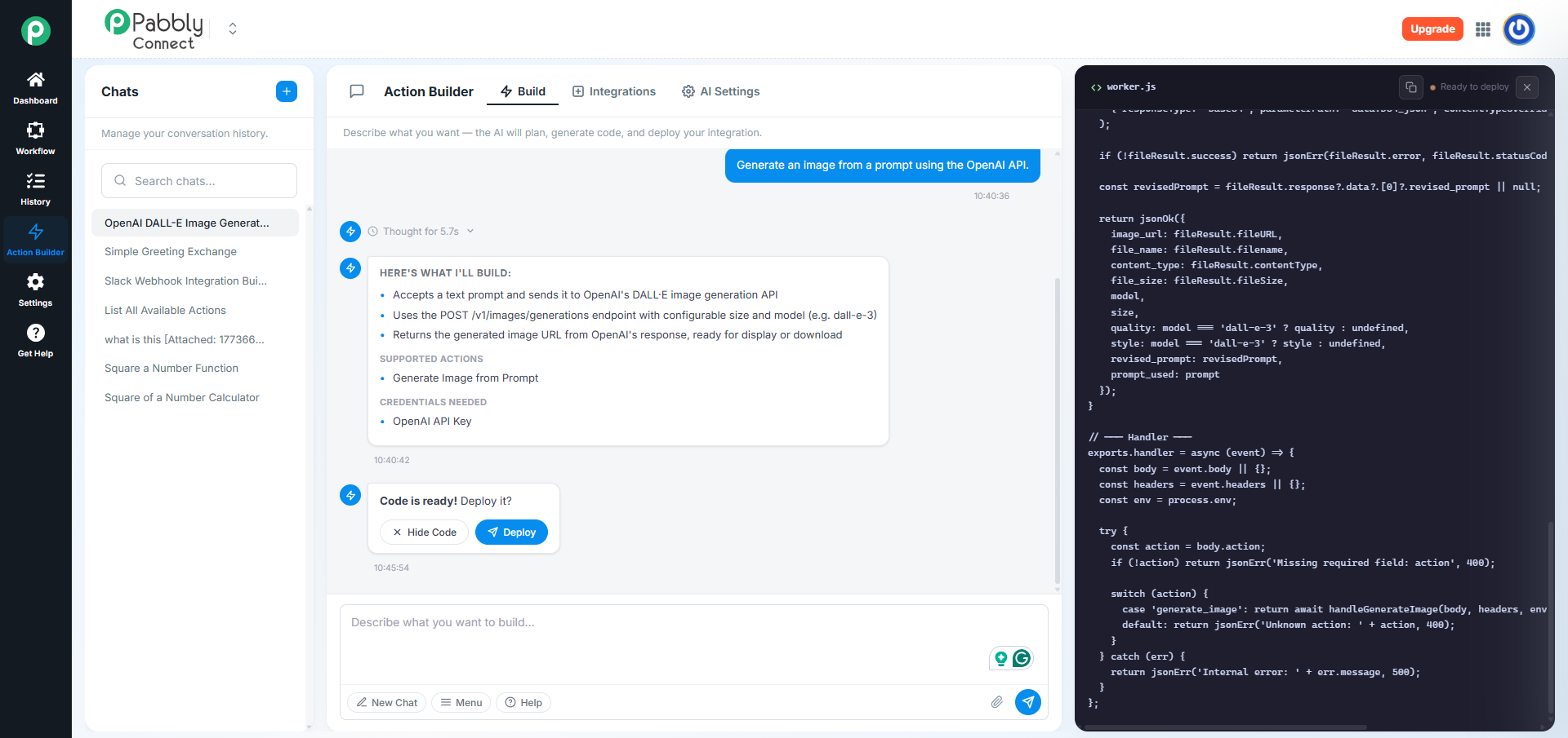

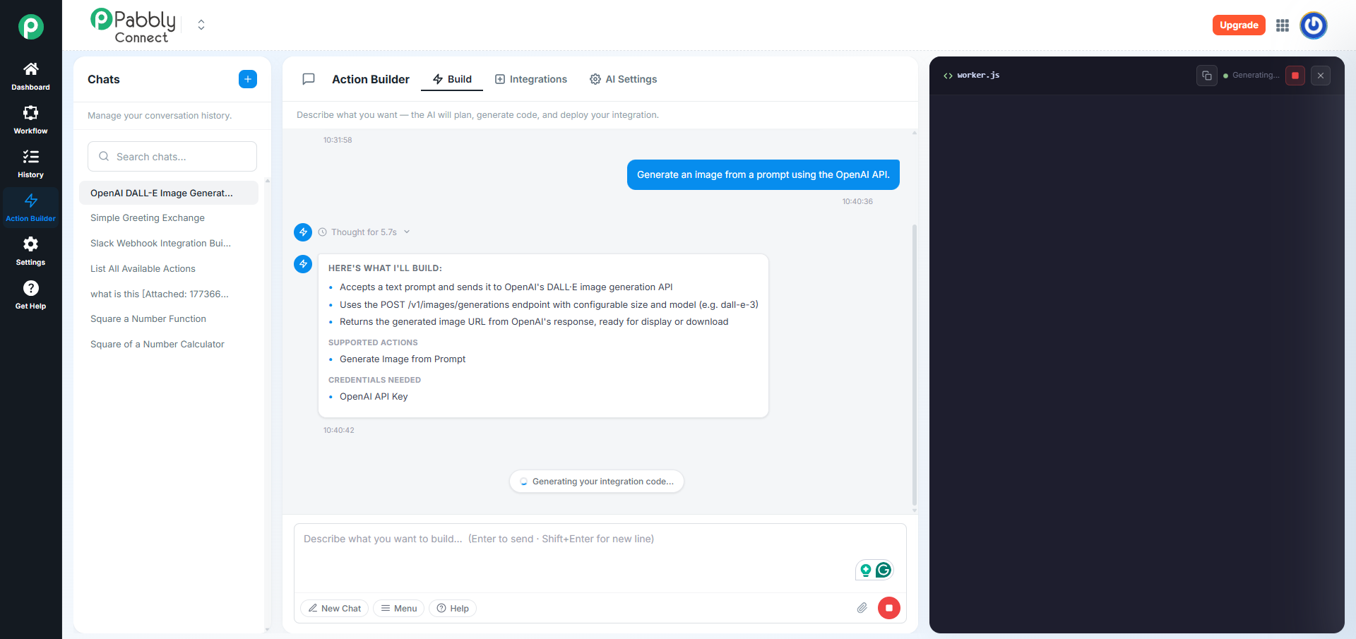

Step 5: Code Generation & Deployment
Once you approve the plan:
1. The AI generates the code in real-time -- you can watch it stream in the code panel.
2. Click
Deploy to deploy the integration to Pabbly Functions.

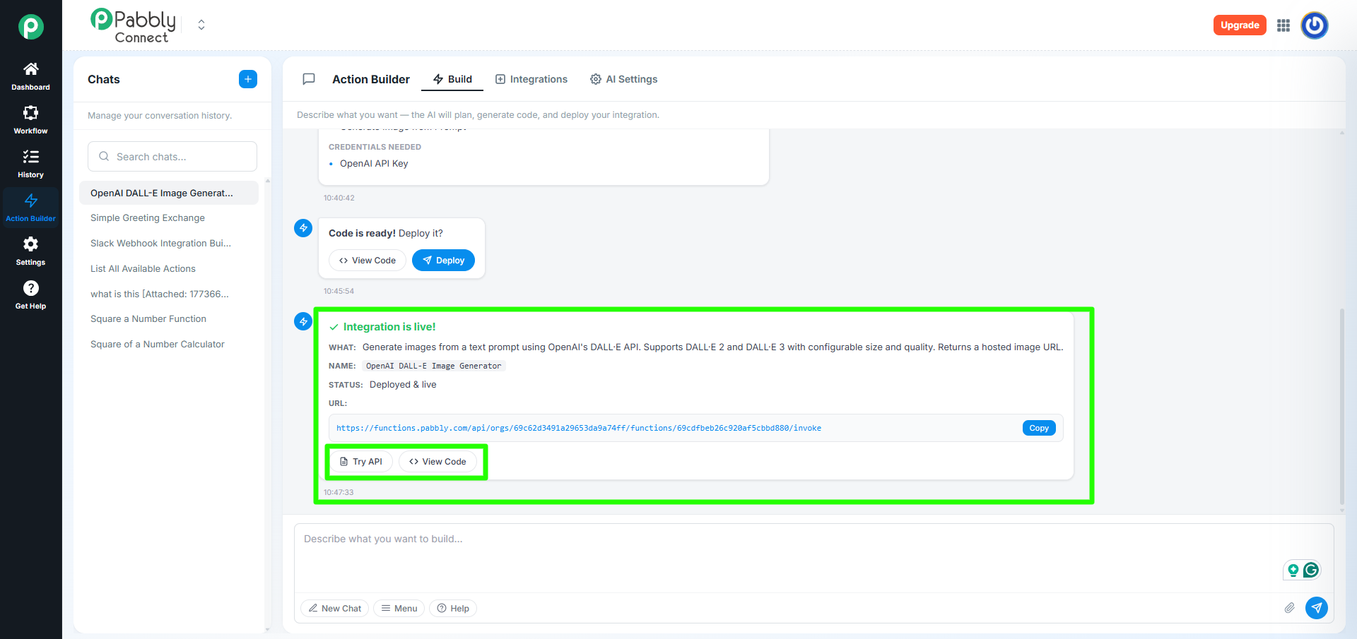

3. You'll see the
"Integration is live!" success card with:
- The invoke URL (your API endpoint)
Try API button to test it immediately
View Code button to see the generated code

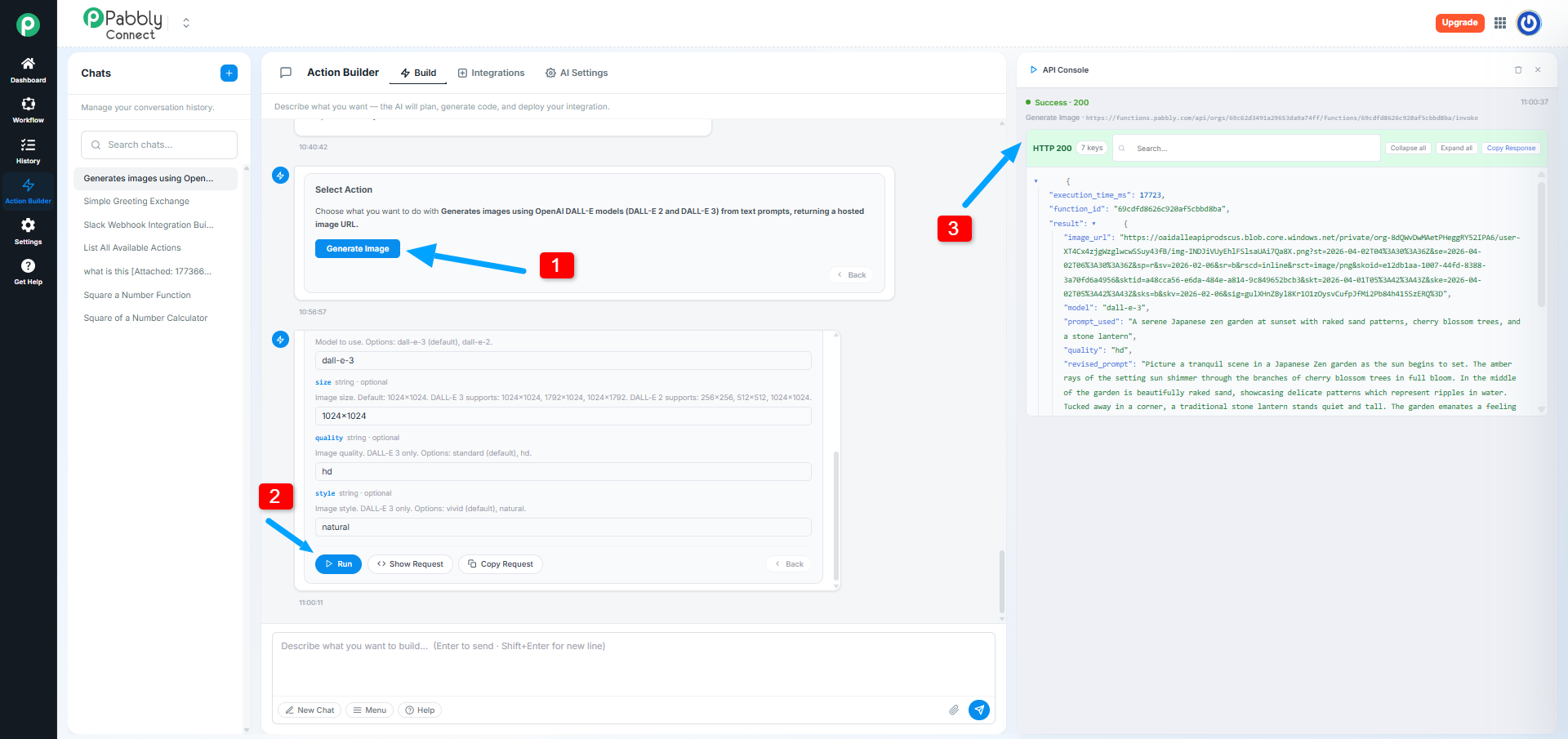

Step 6: Test Your Integration
1. Click the
Try API button on the success card.
2. Select which
action to test.
3. Fill in the required
parameters.
4. Add your
credential headers (API keys, tokens).
5. Click
Run to send a test request.
6. The
API Console panel opens.
7. The response appears showing the status code and JSON data.

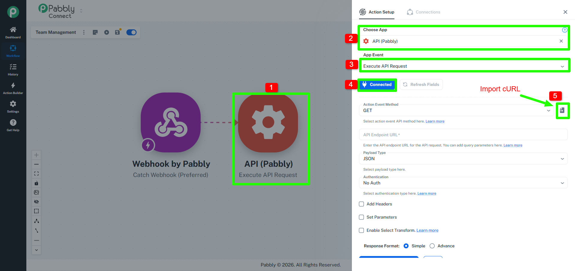

Step 7: Use in Pabbly Connect Workflow
Now that your integration is live, use it as a custom action step:
1. In your workflow, add an
API / Webhook by Pabbly action step (or
HTTP Request / cURL).
2. Set the method to
POST.
3. Paste your integration's
invoke URL.
4. Set
Content-Type: application/json header.
5. Add credential headers (e.g.,
X-Api-Key: your_key).
6. Set the body as JSON:
JSON:
"action": "your_action_name",
"param1": "value from previous step",
"param2": "another value",
"invoked_by": {
"name": "Pabbly Connect",
"email": "[email protected]"
7. Map the fields from previous workflow steps.
