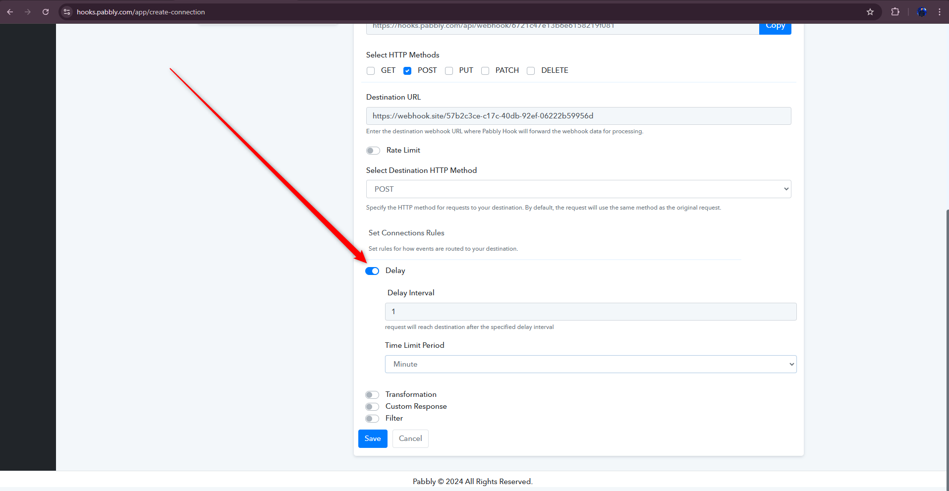

Setting Up a Delay in Pabbly Webhooks
This guide helps you set up a delay for webhook events in Pabbly Hook. Using delay settings, you can manage how long the system waits before sending the next webhook message. This can be especially useful when handling time-sensitive.
- Go to Your Connection Settings:
- Navigate to the specific webhook for which you want to apply a delay.
- Locate the Delay Setting:
- In the connection settings screen, find the "Delay" option (refer to the screenshot below for visual guidance).
3
. Set the Desired Delay Time:
- Enter the delay time, typically in seconds or minutes, depending on your requirement.

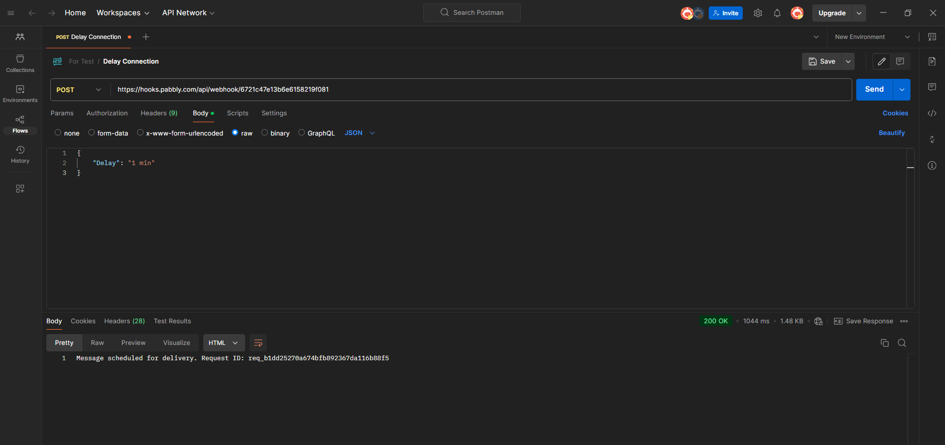

Example : Enter the Delay Time
- In the delay settings, input a delay of 1 minute. This means that after an event is received by the webhook, there will be a 1-minute pause before it is processed and sent to the destination.
Save and Apply the Delay:
- After entering 1 minute as the delay time, save the configuration to apply it to the webhook and get the webhook url and copy that.(refer to the screenshot below for visual guidance).

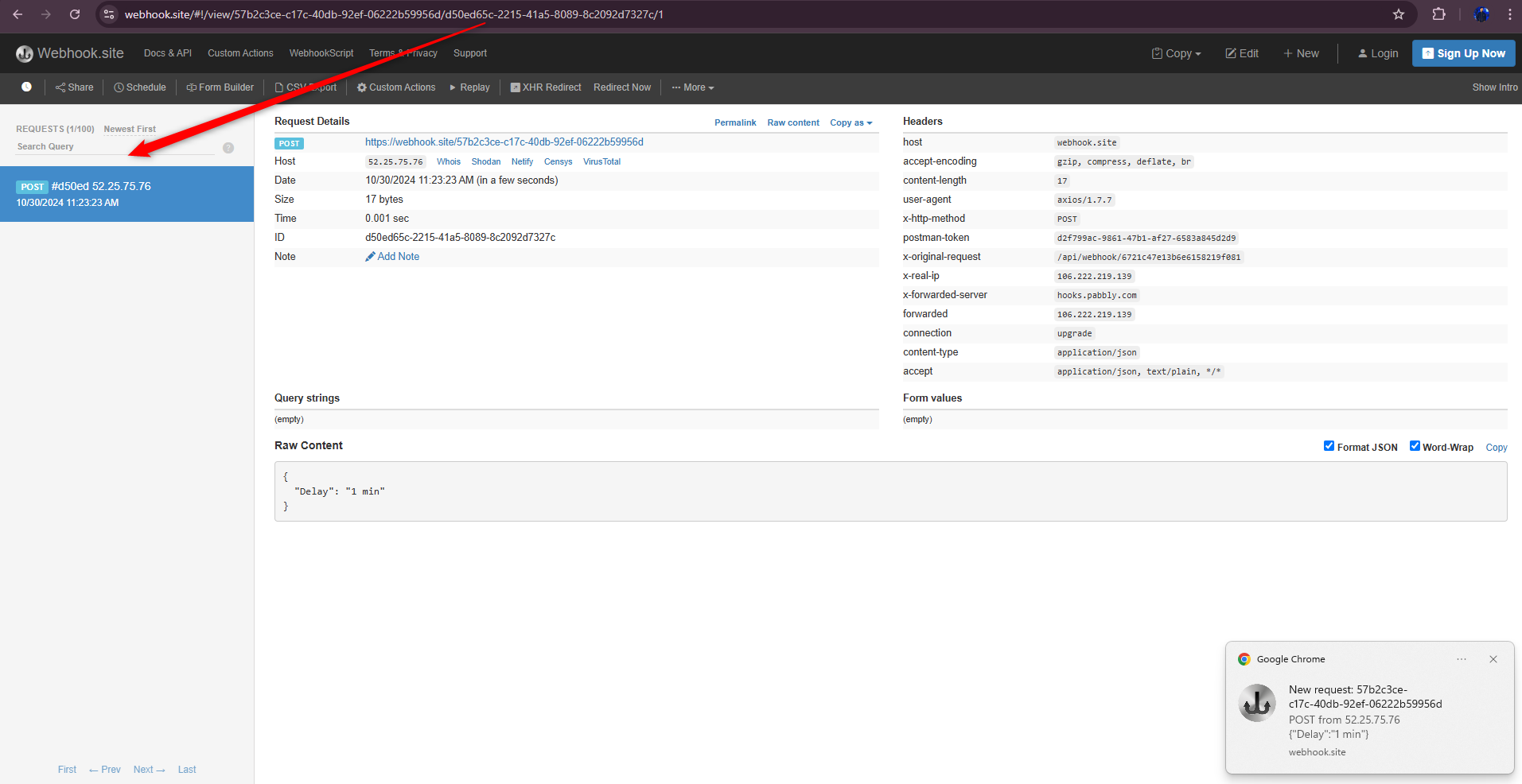

Observe the Delay in Action:
- Once the delay is set, test the webhook by triggering an event to see how the delay affects the timing.
- After the event is triggered, check that the event doesn’t reach the destination immediately. Instead, it should be held in a queue by Pabbly Hook and only sent to the endpoint after the 1-minute delay(refer to the screenshot below for visual guidance).
Verify Delivery after 1 Minute:
- To confirm, monitor the destination endpoint and ensure the event is received exactly 1 minute after the trigger action was initiated(refer to the screenshot below for visual guidance).
- This allows you to check that the delay setting is working correctly and enforcing the 1-minute rate limit.
Using this configuration, you can effectively control the timing of event deliveries, which can prevent rate-limit issues with the receiving service or create a buffer to handle heavy webhook loads.

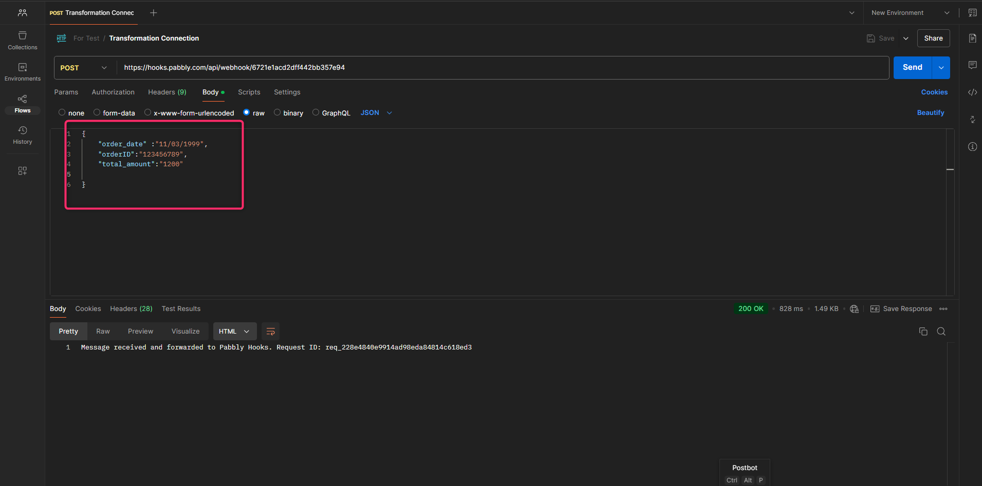

Use Case Example: Adjusting Data Format for Compatibility
Suppose an incoming webhook sends a payload with a date in MM/DD/YYYY format, but the receiving application needs it in YYYY-MM-DD format. A transformation can be applied to reformat this date before forwarding it.

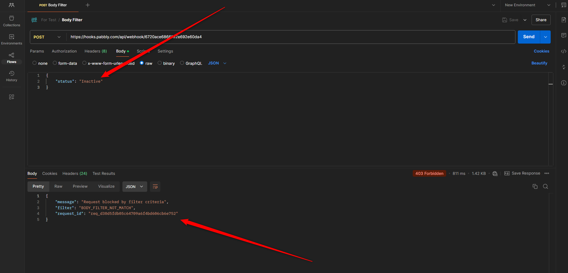

Filter rules are run after any transformation has been performed.

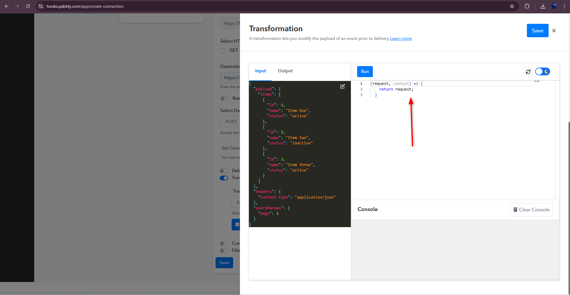

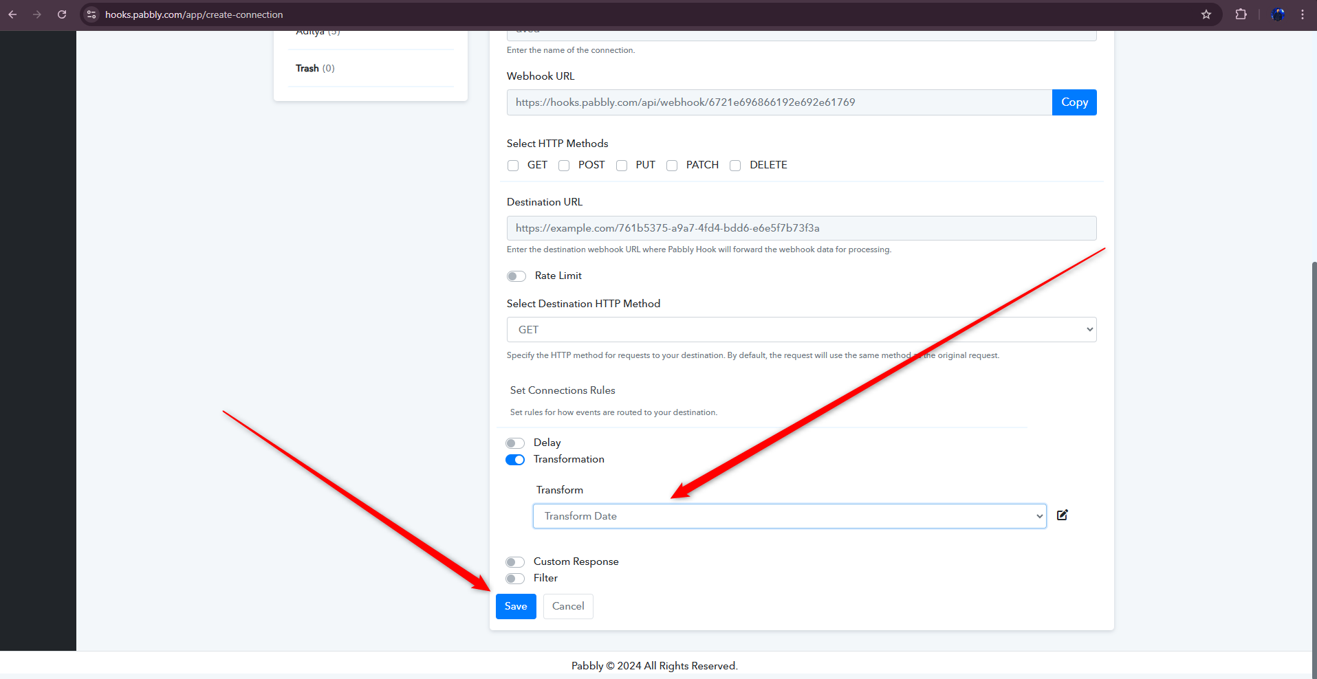

Setting up a Transformation

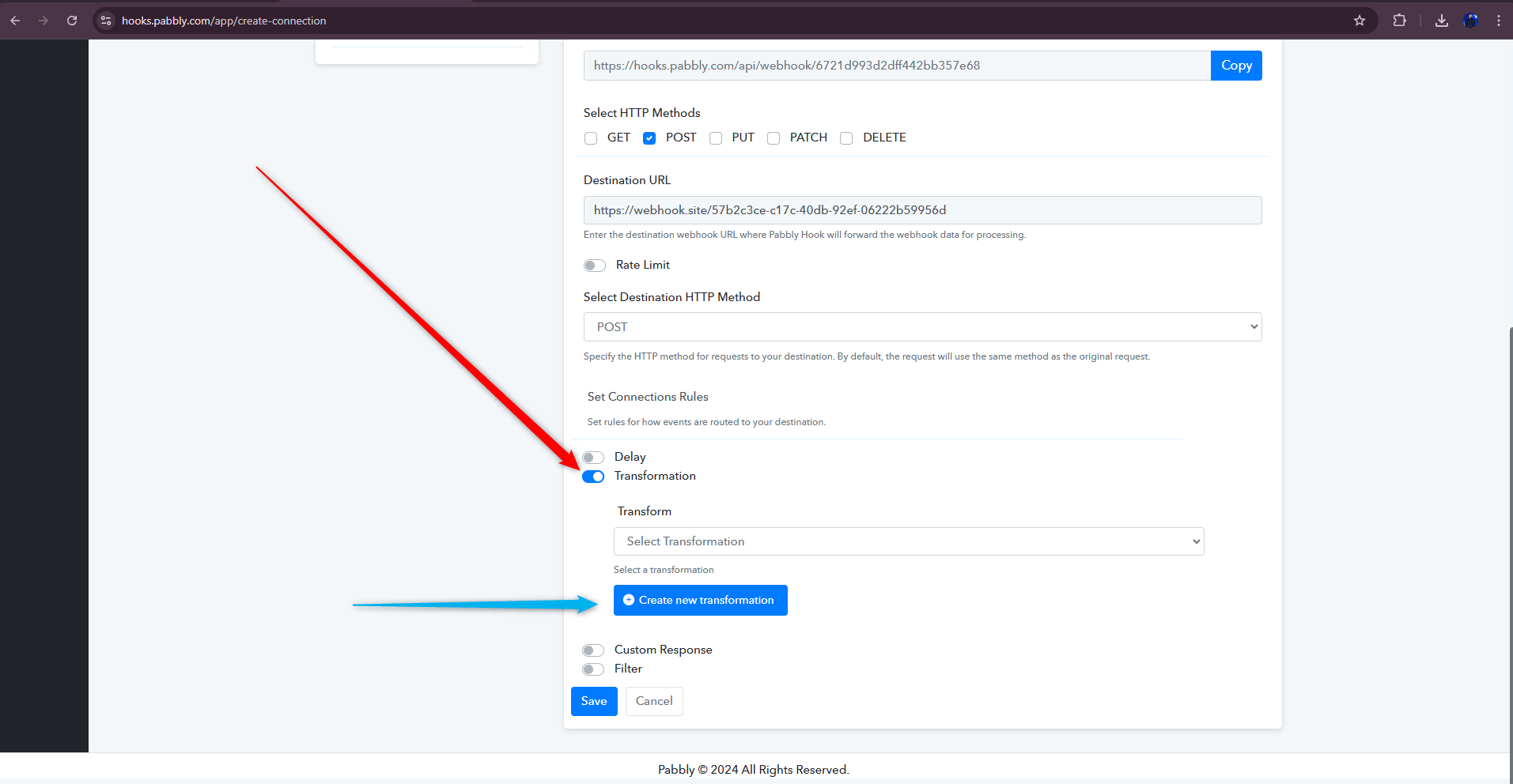

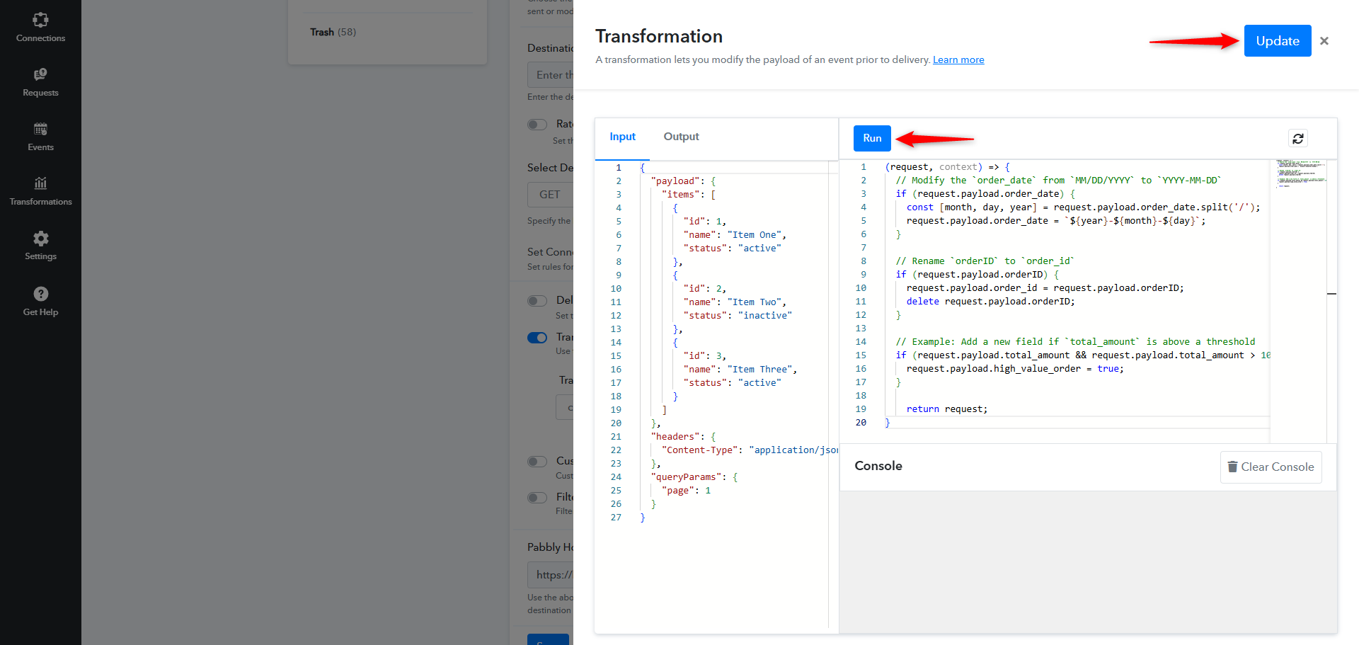

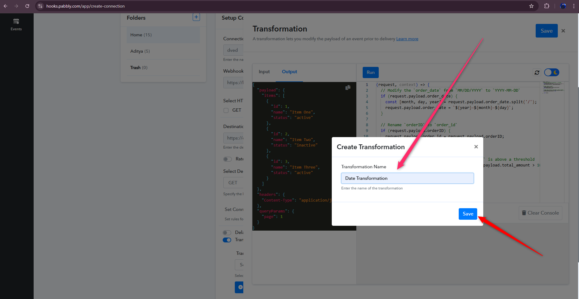

- Navigate to the Transformation Section: In Pabbly hook, locate the connection where you want to apply a transformation. Under the hook settings, find the "Transformations" section.
- Click Transform to add a transformation rule.
- Click Create new transformation.
- Configure the transformation using the supported transformations syntax in the right-hand pane.
5.

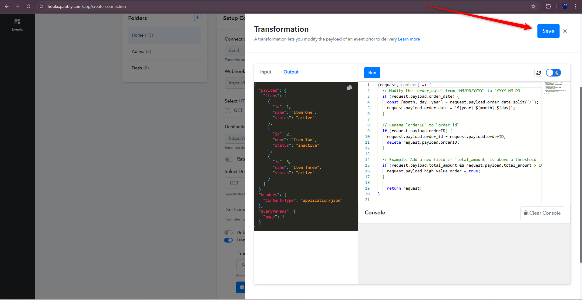

Define the Transformation Logic: You can specify transformations using code to alter the incoming request's body, headers, or path parameters and add code snippet for transformation.
6. Once written, test your transformation.
- The left pane's Input tab shows the request your transformation will be tested against. To change this request, click edit tab and select a recent payload, or edit the text directly.
- Click Run to test the transformation. Once run, the left pane's Output tab shows the resulting payload.
7. Once satisfied with the transformation, click
Save.
8. Name the transformation using the input field in the pop-up box, clicking
Save to save the transformation.
9. Make sure to select the saved transformation from dropdown and click Save again on the connection form to apply your changes.
Here’s an example code snippet to reformat a date field and rename a parameter for better compatibility.
10. From this point forward, events received on the connection are transformed prior to delivery to their destination.

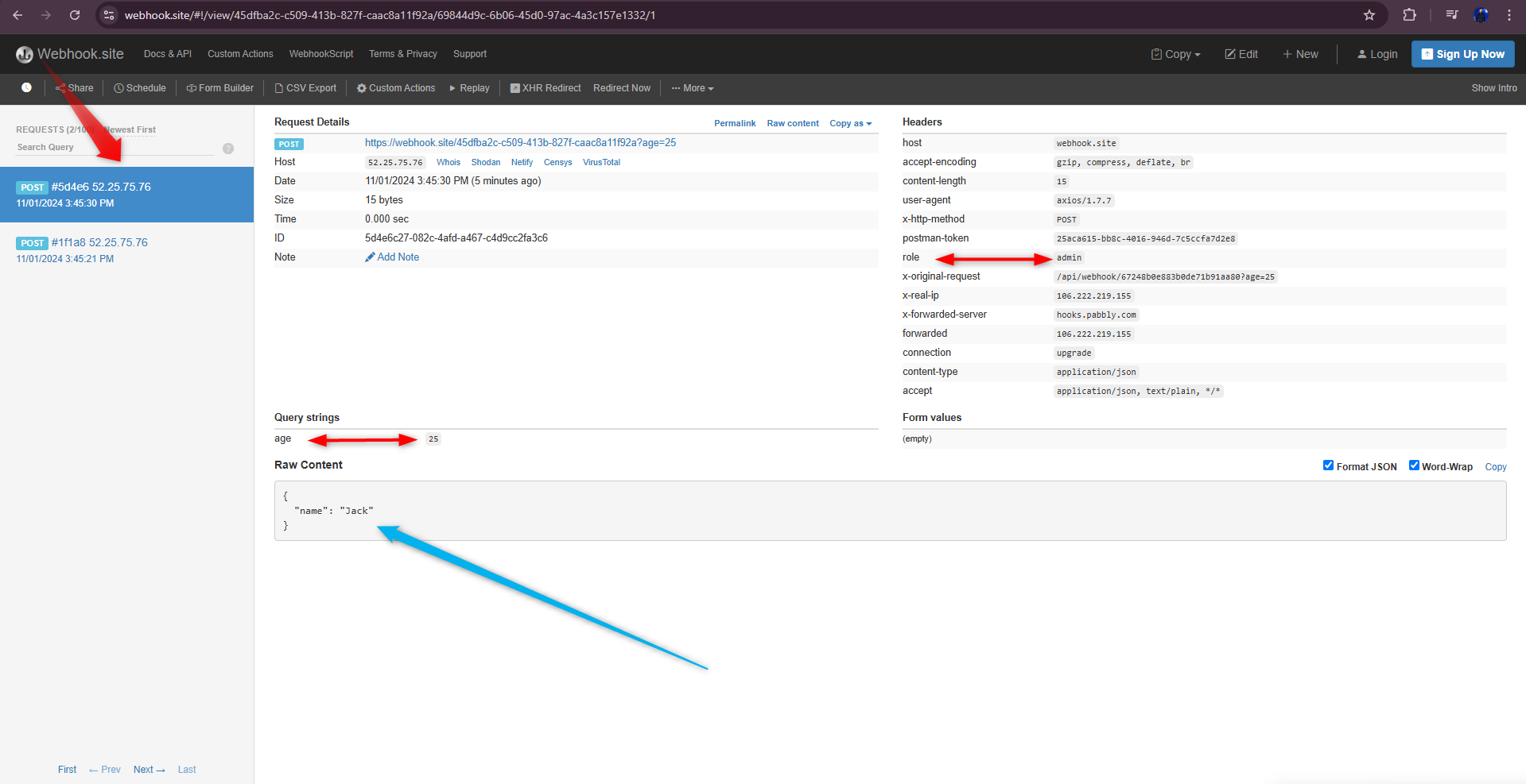

# Example Transformation Code Including Payload , Headers , Query Params.
JavaScript:
Code:
(request, context) => {
// Modify the `order_date` from `MM/DD/YYYY` to `YYYY-MM-DD` in payload
if (request.payload.order_date) {
const [month, day, year] = request.payload.order_date.split('/');
request.payload.order_date = `${year}-${month}-${day}`;
// Rename `orderID` to `order_id` in payload
if (request.payload.orderID) {
request.payload.order_id = request.payload.orderID;
delete request.payload.orderID;
// Add a new field in payload if `total_amount` is above a threshold
if (request.payload.total_amount && request.payload.total_amount > 1000) {
request.payload.high_value_order = true;

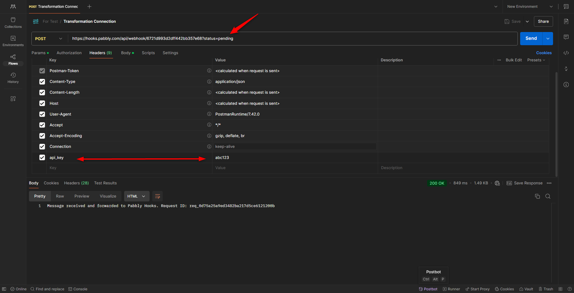

// Modify `api_key` header for consistency
if (request.headers['api_key']) {
request.headers['API_KEY'] = request.headers['api_key'];
delete request.headers['api_key'];
// Add a new header if `Content-Type` is missing
if (!request.headers['Content-Type']) {
request.headers['Content-Type'] = 'application/json';

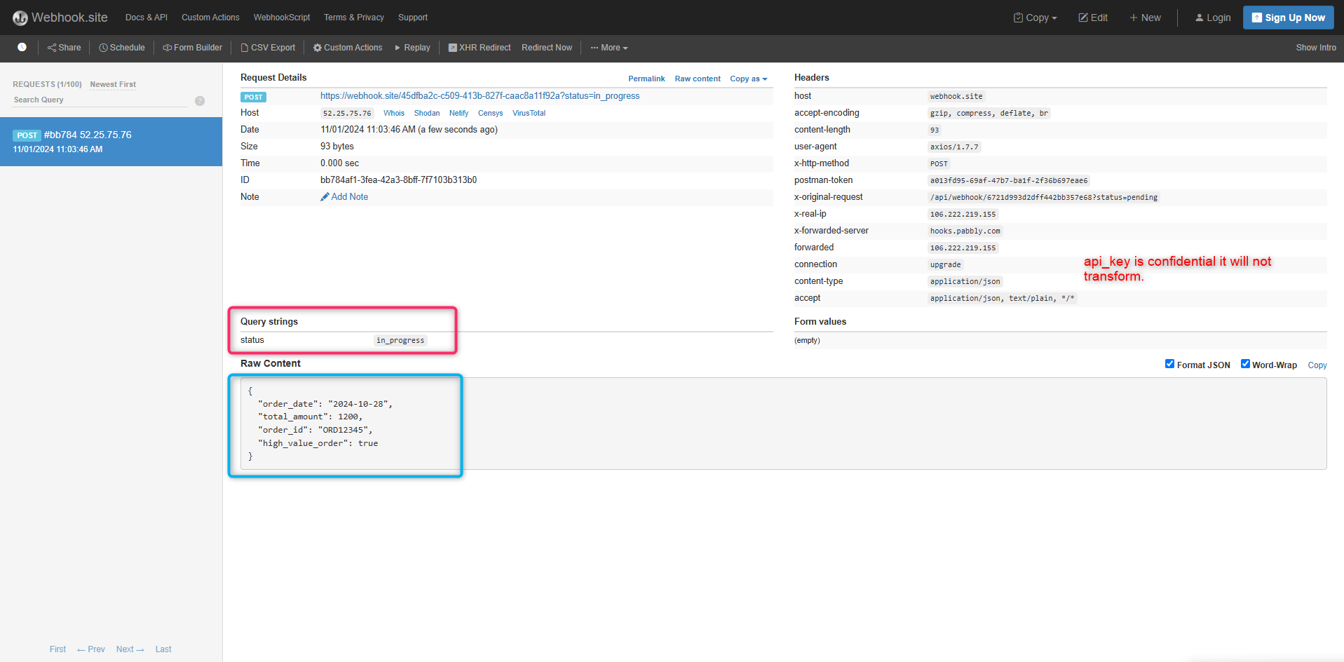

// Update query param `status` from "pending" to "in_progress"
if (request.queryParams.status === 'pending') {
request.queryParams.status = 'in_progress';
return request;
- Payload Adjustments:
- Reformats order_date to YYYY-MM-DD.
- Renames orderID to order_id.
- Adds high_value_order if total_amount is greater than 1000.
- Header Adjustments:
- Renames api_key to API_KEY.
- Sets Content-Type to application/json if it was missing.
- Query Parameter Adjustments:
- Changes status from "pending" to "in_progress" if necessary.

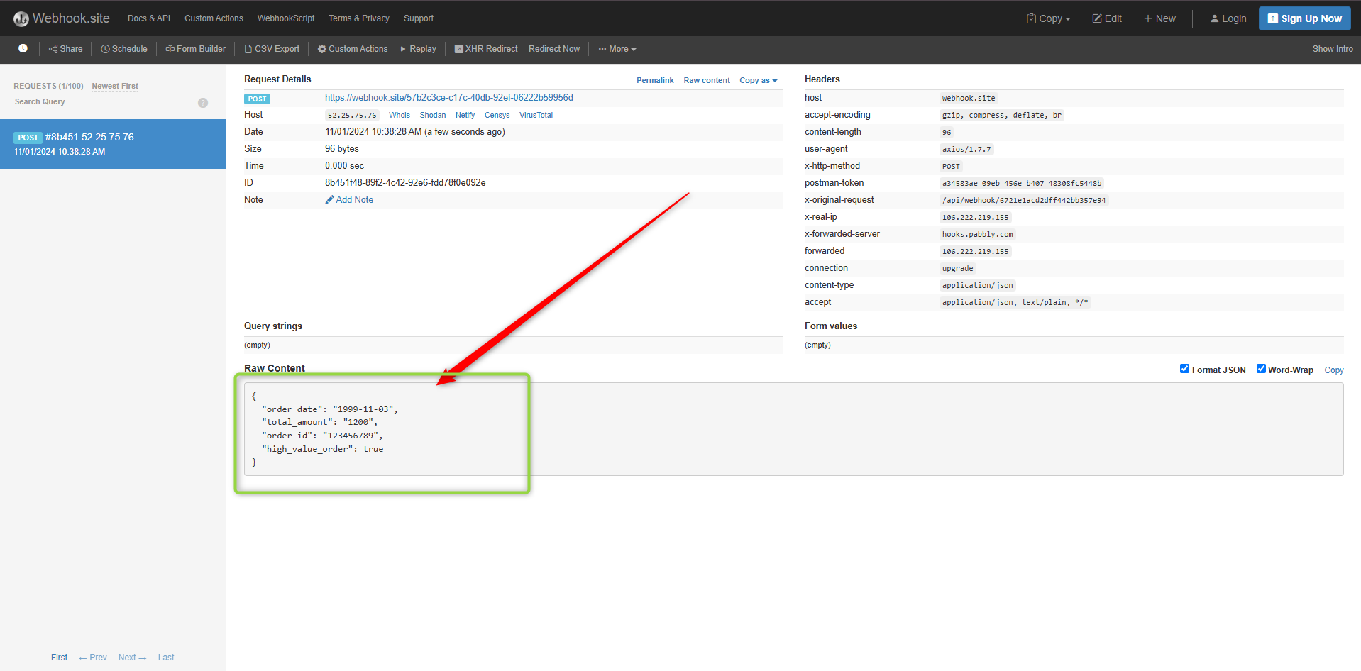

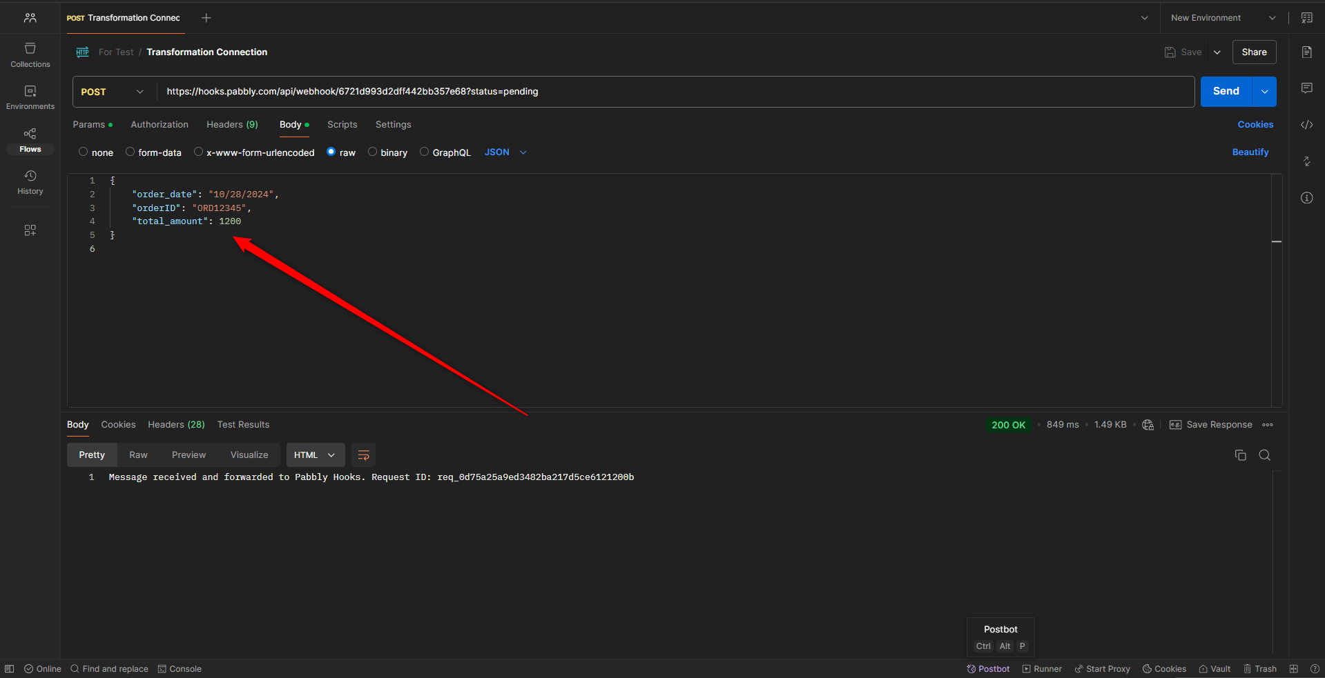

Here’s an example of how the input might look before applying the transformation:
Output Example
After applying the transformation, the output will look like this:

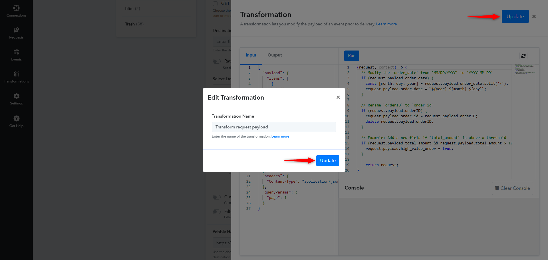

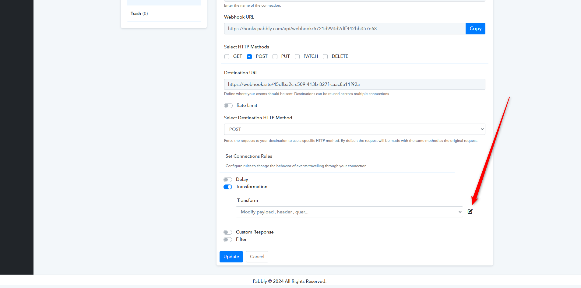

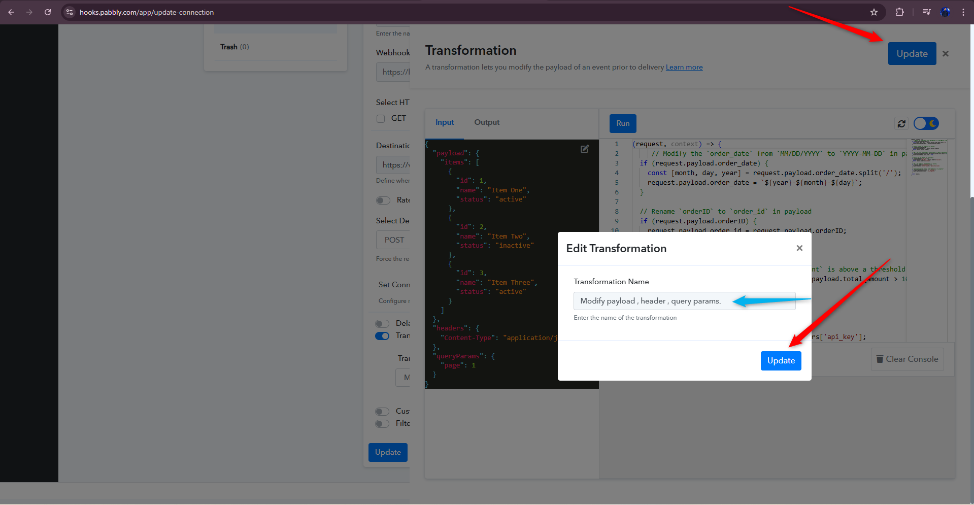

Editing a transformation changes how payload data is transformed before delivery.
- Open the connection rules configuration.
- Navigate to the Transformation Section: Choose the transformation you want to update.
- Next to the transformation rule, click Editor Button(Screenshot for your's refrence).
- Configure the transformation using the supported transformation syntax in the right-hand pane.
- Once written, test your transformation.
- The left pane's Input tab shows the request your transformation will be tested against. To change this request, click Change and select a recent payload, or edit the text directly.
- Optionally, you may rename the transformation using the input field in the pop up box. Click Update to confirm the name change.
- Once satisfied, click Update.
- Make sure to click Update again on the connection form to apply your changes.
Keep in mind that updating a transformation will affect all connections that use the same transformation. If this is not your desired behavior, you can create a new one.

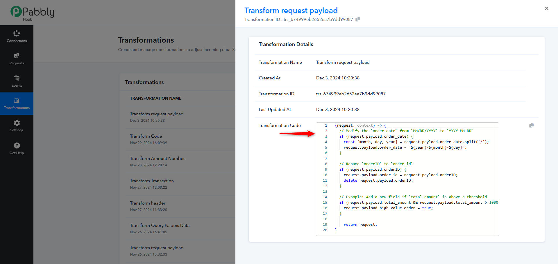

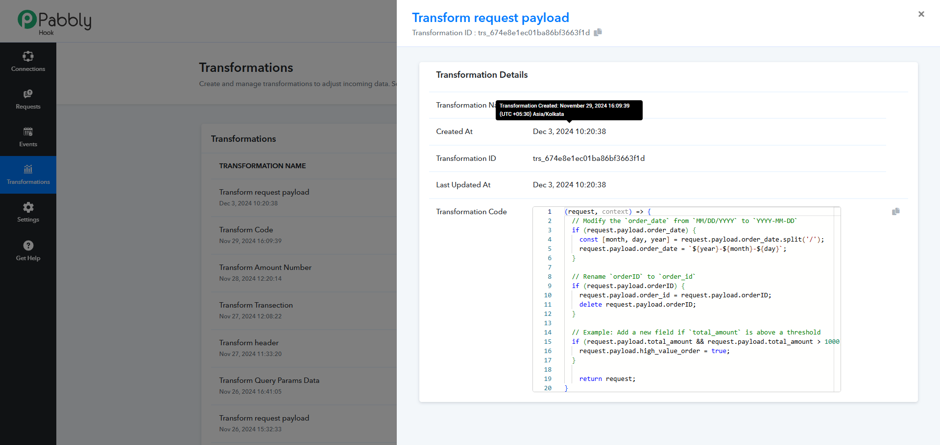

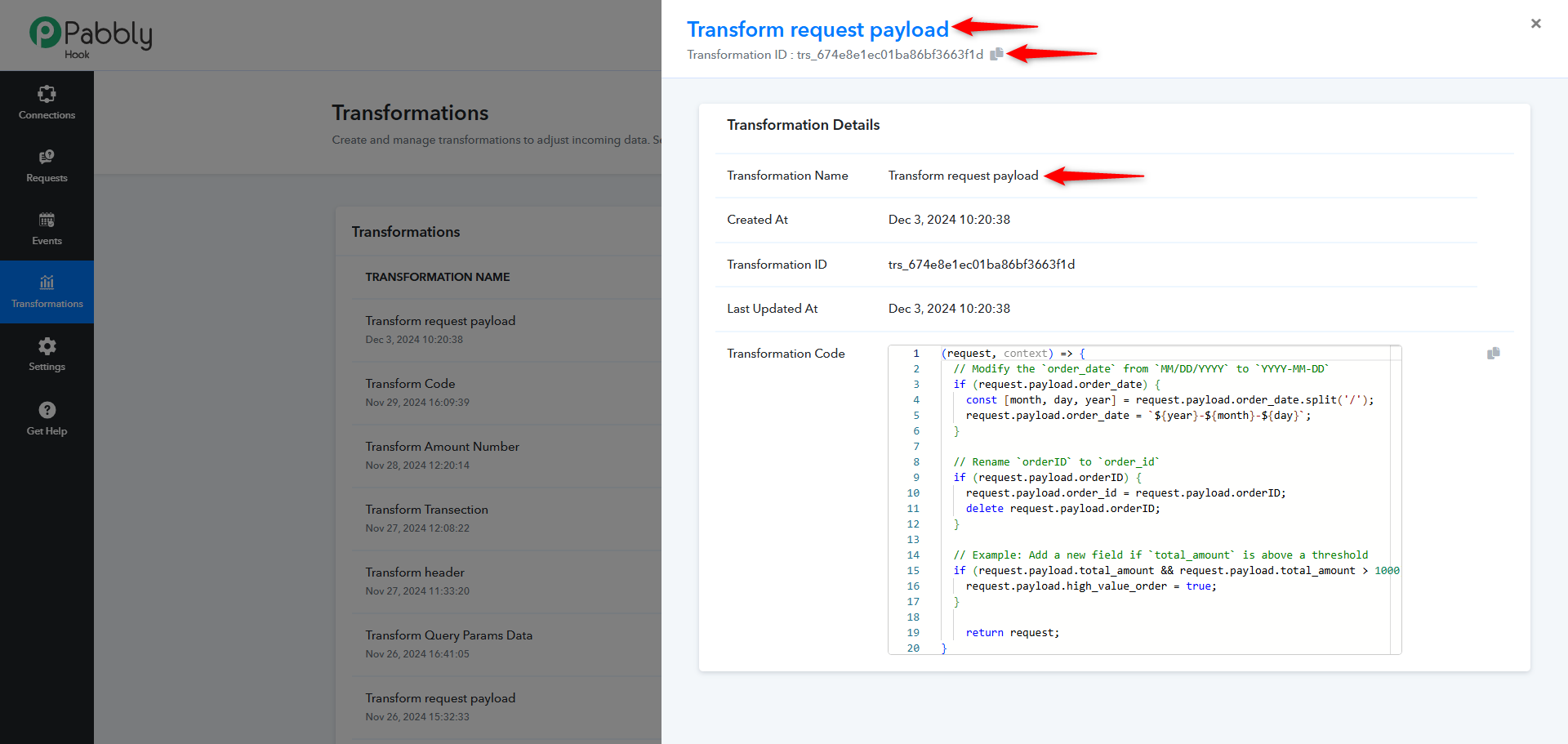

Definition
The
Transformation Modal View in Pabbly Hook allows users to view and manage the details of a specific transformation created within the system. This feature is accessible by selecting a transformation from the "Transformations" list on the left-hand side vertical navigation bar.
Features and Fields Explained
1. Transformation Name
- Location: Top of the modal, prominently displayed.
- Purpose: Identifies the name of the selected transformation for quick reference.
- Editable: No, it reflects the name assigned during transformation creation.
2. Created At
- Location: Below the transformation name.
- Purpose: Indicates the exact timestamp when the transformation was initially created.
- Format: Follows the MMM DD, YYYY HH:MM:SS format for easy readability.
3. Transformation ID
- Location: Listed alongside other metadata.
- Purpose: Provides a unique identifier for the transformation. This is particularly useful for debugging or referencing the transformation in API calls.
- Editable: No, it is automatically generated by the system.
4. Last Updated At
- Location: Next to the "Created At" field.
- Purpose: Displays the most recent timestamp when the transformation was modified. Useful for tracking changes.
- Format: Same as the "Created At" field.
5. Transformation Code
- Location: In the main content section of the modal.
- Purpose: Shows the actual JavaScript code used for the transformation.
- Key Features:
- Syntax Highlighting: Ensures better readability of the code.
- Code Examples: Includes comments for common use cases, such as:
- Changing date formats.
- Renaming fields.
- Adding conditional fields based on specific logic.
- Change Date Format:
request.payload.order_date = ${year}-${month}-${day};
- Rename Fields:
- Add Conditional Fields:

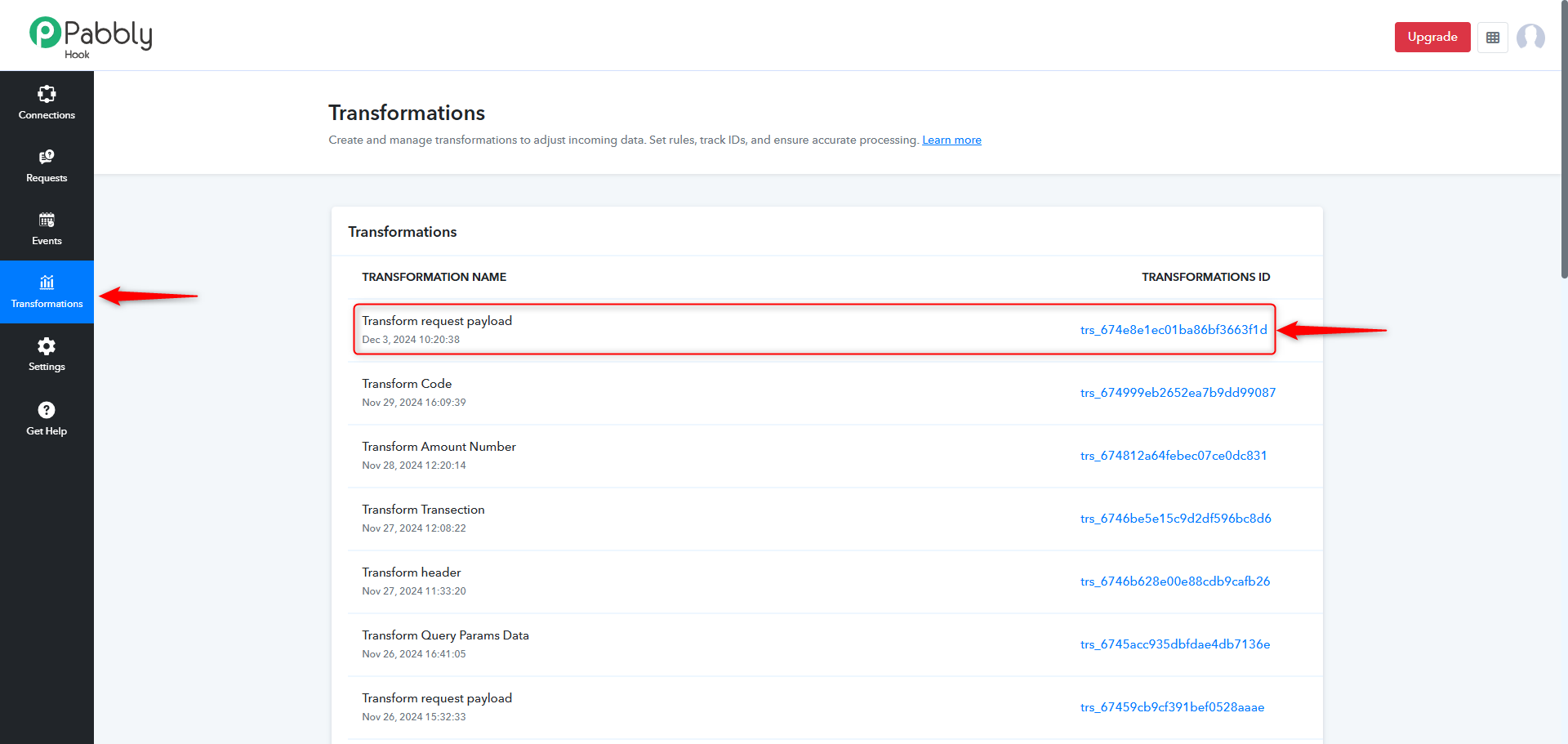

- Viewing Transformation Details:
- Navigate to the "Transformations" section from the sidebar.
- Click on the desired transformation ID to open the modal view.
- Editing Transformation Code:
- Locate the "Transformation Code" section.
- Modify the code as needed. For example:
- Change the date format from MM/DD/YYYY to YYYY-MM-DD.
- Rename fields or add custom logic using JavaScript.
- Saving Changes:
- After making modifications, click the "Update" button (if available).
- Debugging:
- Use the Transformation ID to trace logs or identify issues in webhook integrations.
Additional Note on "Created At" Field
The
"Created At" field in the transformation modal includes a timezone specification in the format:
Transformation Created: November 29, 2024 16:09:39 (UTC +05:30) Asia/Kolkata

This additional detail ensures that users can track transformations with precision, even in a multi-time-zone environment.
Best Practices
- Validate Code: Before saving, ensure your JavaScript code is error-free to avoid runtime issues.
- Test Changes: Test the transformation using sample payloads to confirm it behaves as expected.
This documentation provides a comprehensive understanding of the transformation modal view in Pabbly Hook, ensuring users can efficiently manage and customize their transformations.

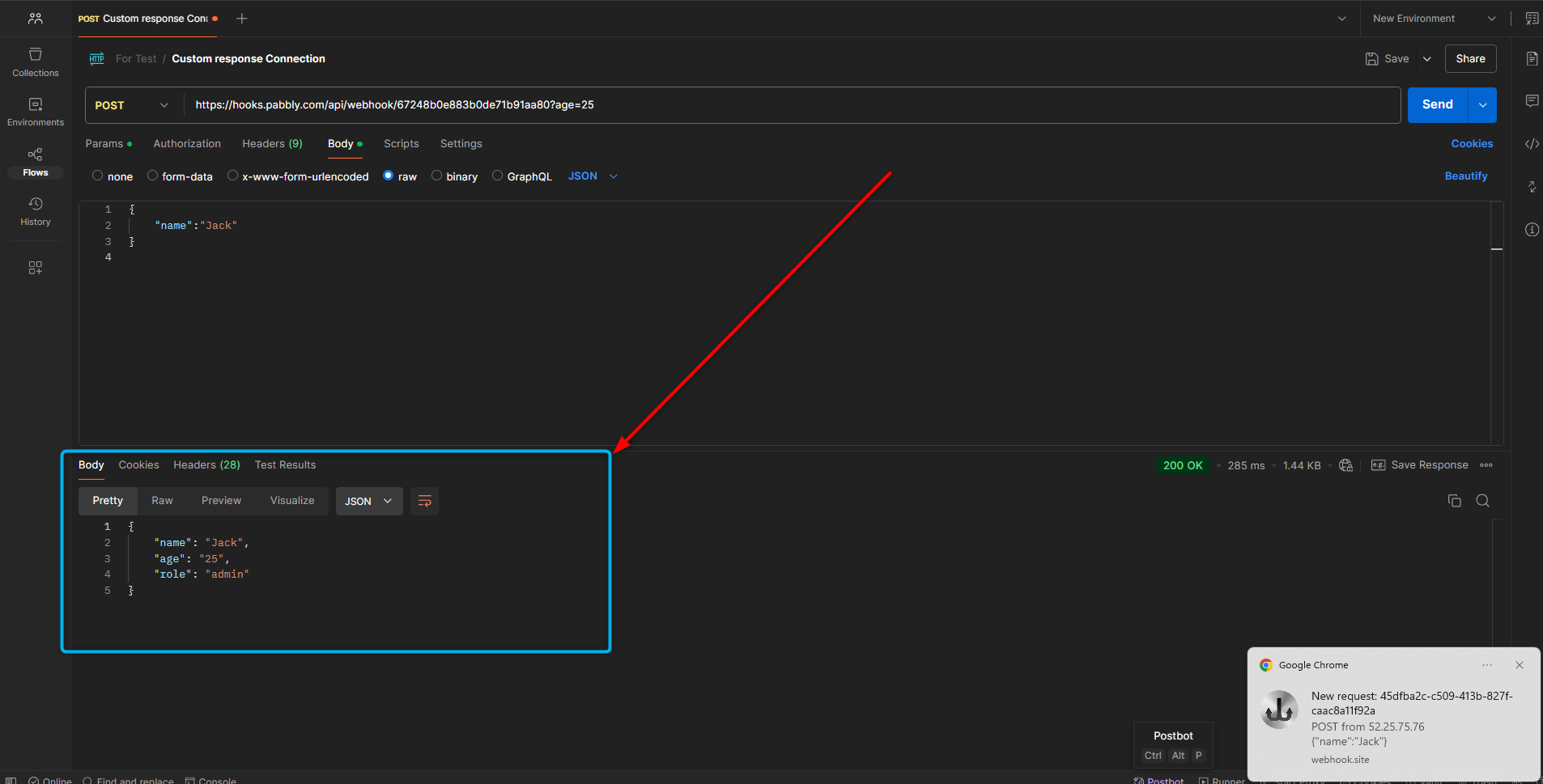

How to Set a Custom Response in Pabbly Hook
To set a custom response, follow these steps:

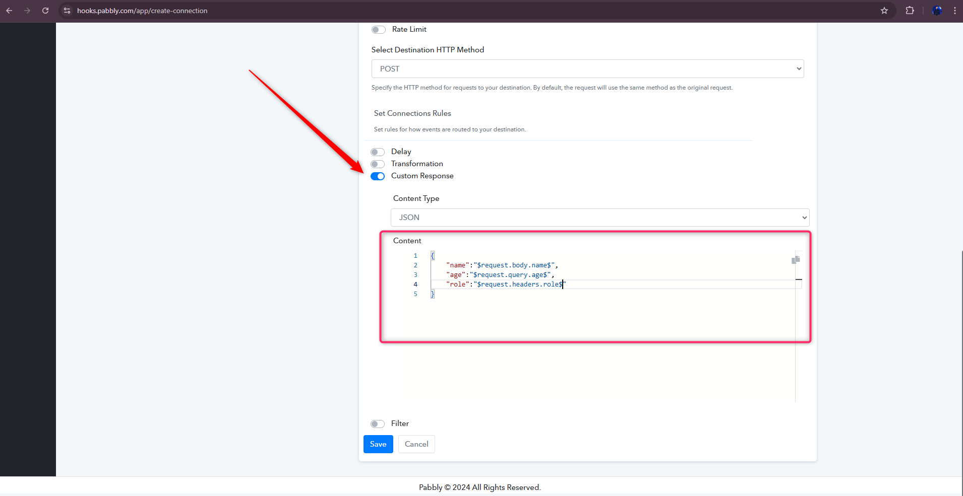

- Navigate to the Custom Response Section: In Pabbly hook, locate the connection where you want to apply a custom response. Under the hook settings, find the "Custom Response" section.
- Activate the Custom Response: Mark the custom response as active to enable it for the webhook.
- Configure the custom response using Content Type and Content.
- Specify the Content Type: Choose the appropriate content type (e.g., application/json, text/plain) to ensure the response meets any specific format requirements.
- Define the Custom Response Content: Customize the response content with placeholders to insert request data dynamically.
- Use $request.body.<key>$ to replace placeholders with values from the request body.
- Use $request.query.<key>$ for values from query parameters.
- Use $request.headers.<key>$ for values from headers.
- Once satisfied with the custom response, click Save.

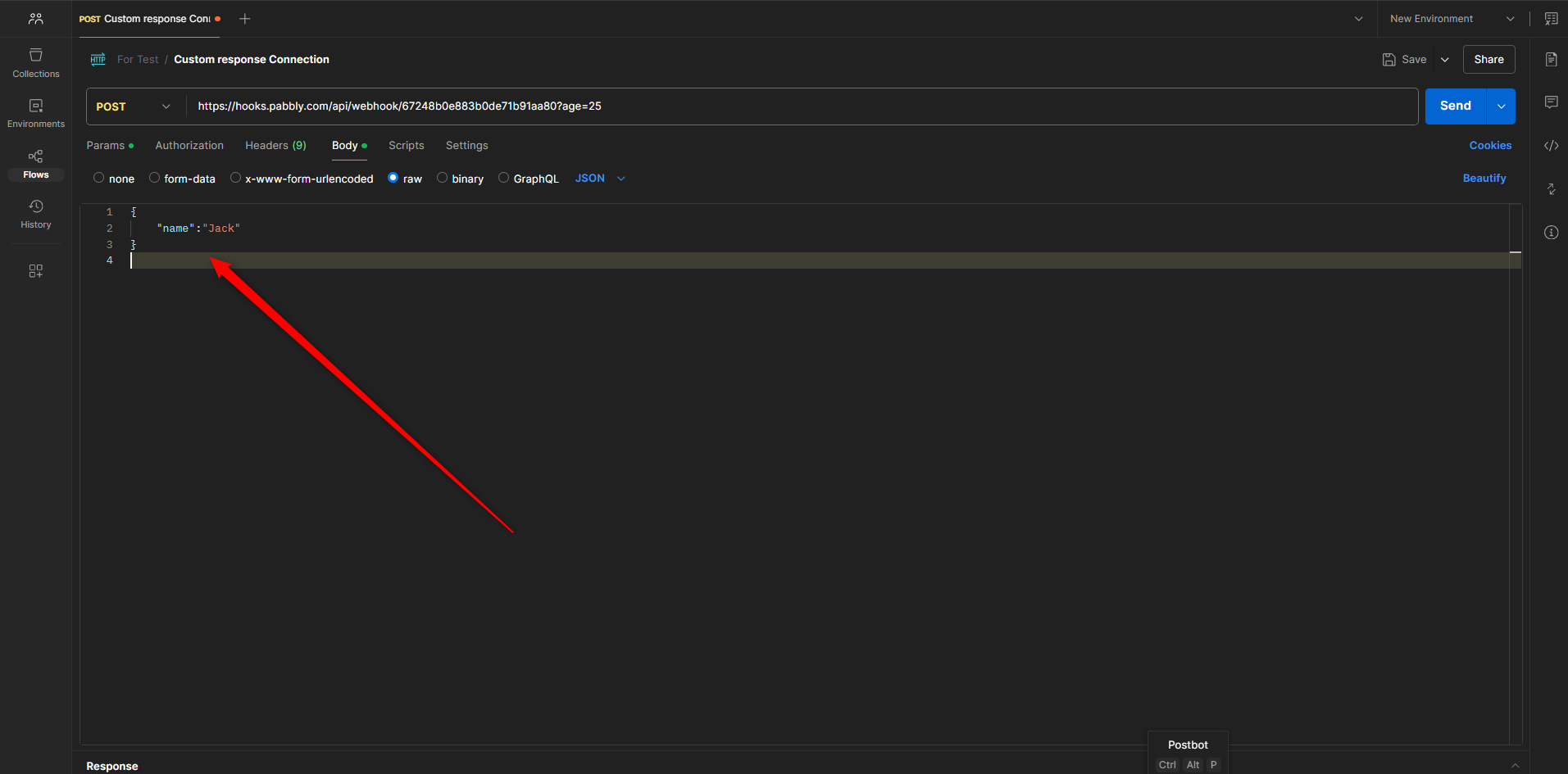

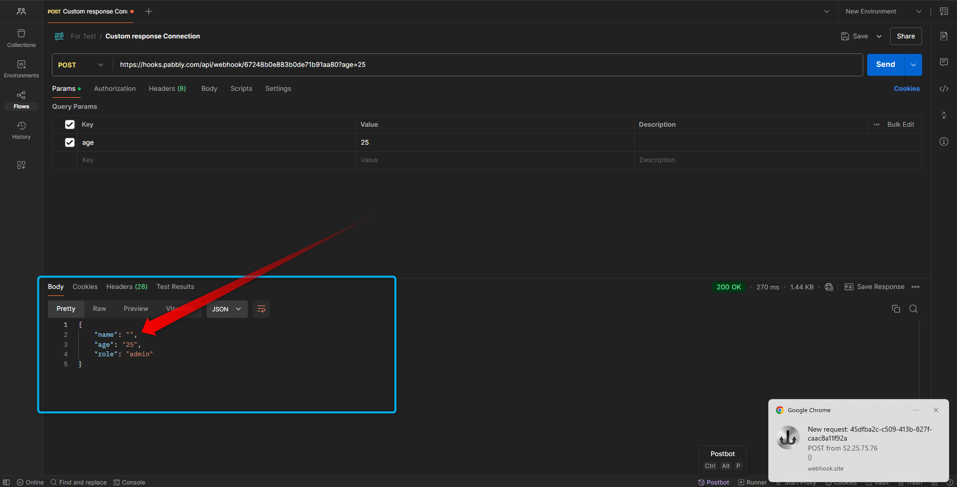

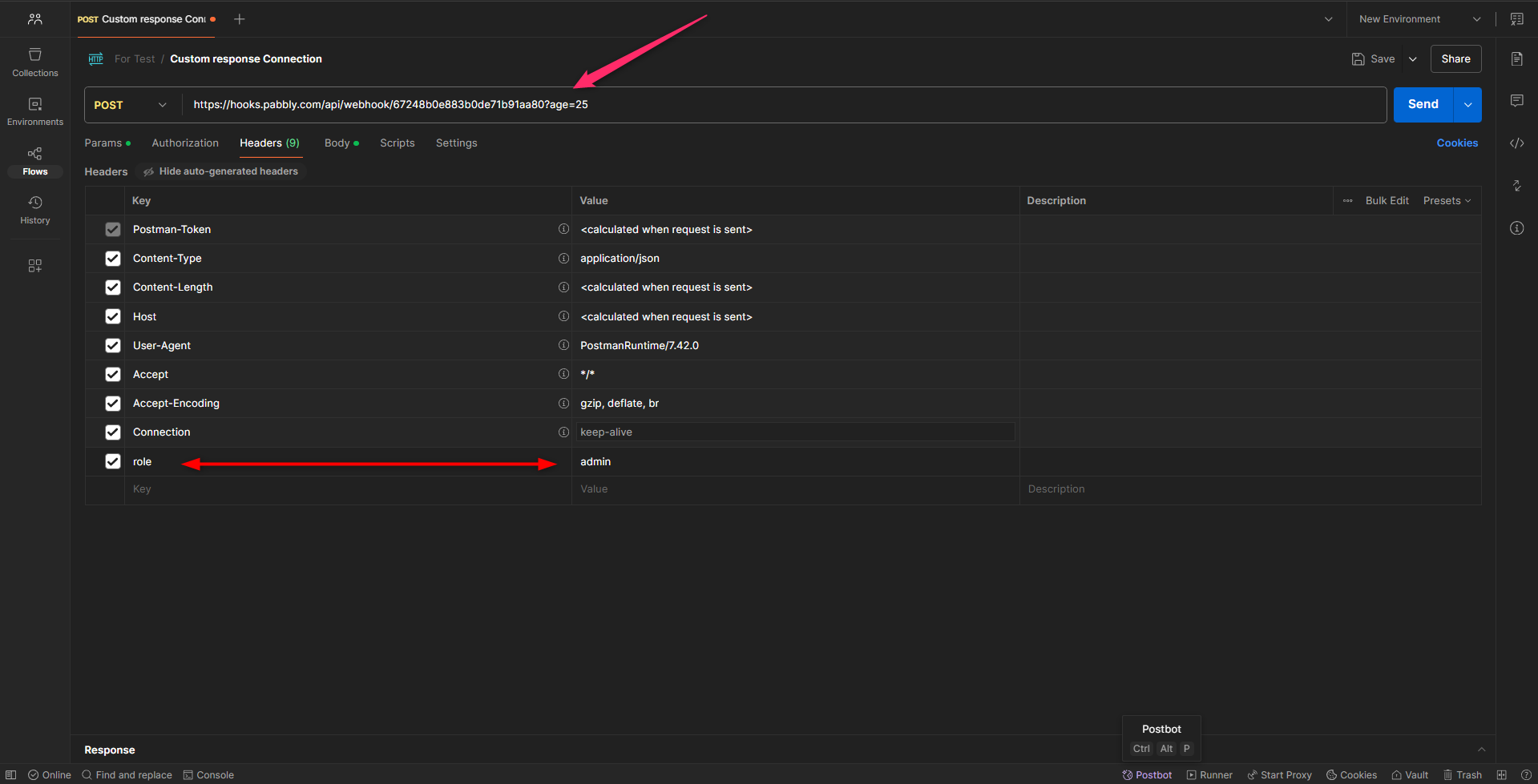

- Now you can send the webhook and check the custom response(Below is the screen shot for your reference).
- Now you see the custom response while triggering the webhook(Below is the screen shot for your reference).
Note: If there is no key provided then the custom response value will be empty for that key(Below is the screen shot for your reference).
Example : I will not send name in body.

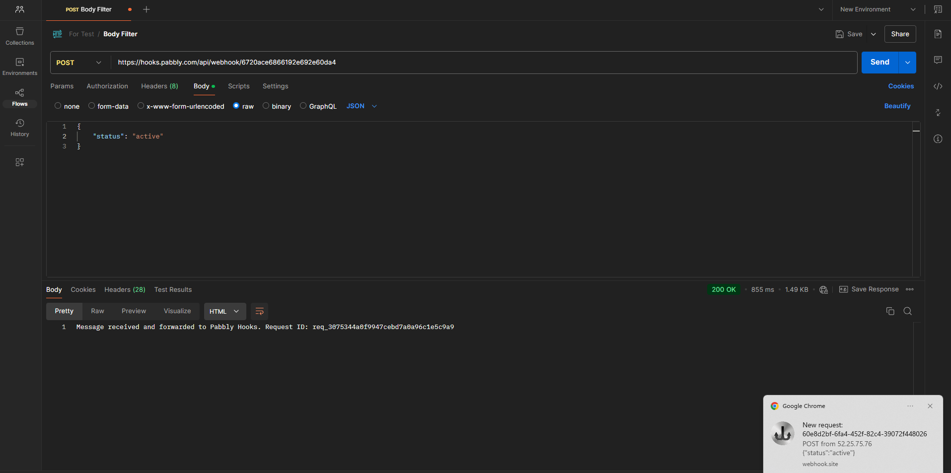

1. Body Filter
A
Body Filter is used to apply rules on the content within the request body. This type of filter is useful when you need to check if certain fields in the payload contain specific values.
- Example: Body Filtering on the status field to process only messages with "status": "active".
- If "status": "active" is not matched in body it will block the request.
- Example: Filtering on the status field to process messages with "status": "Inactive".

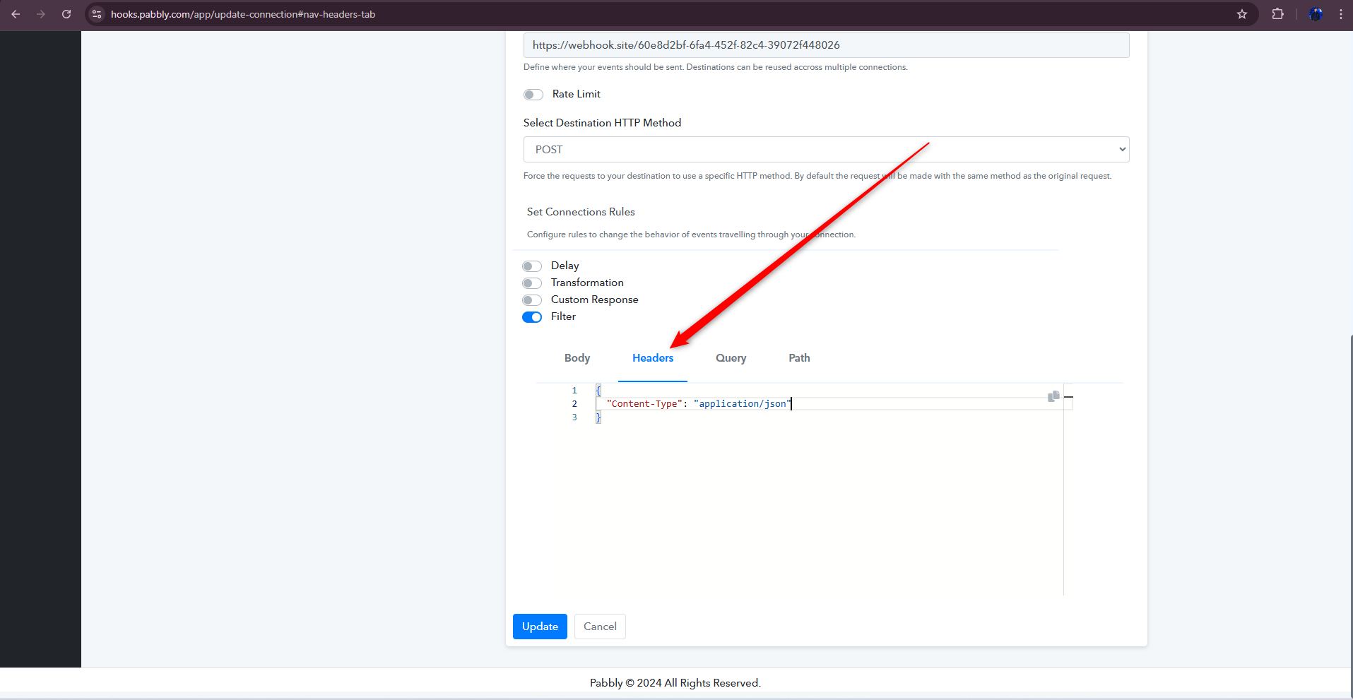

2. Header Filter
A
Header Filter checks specific headers in the request, allowing you to validate metadata or control data processing based on headers.

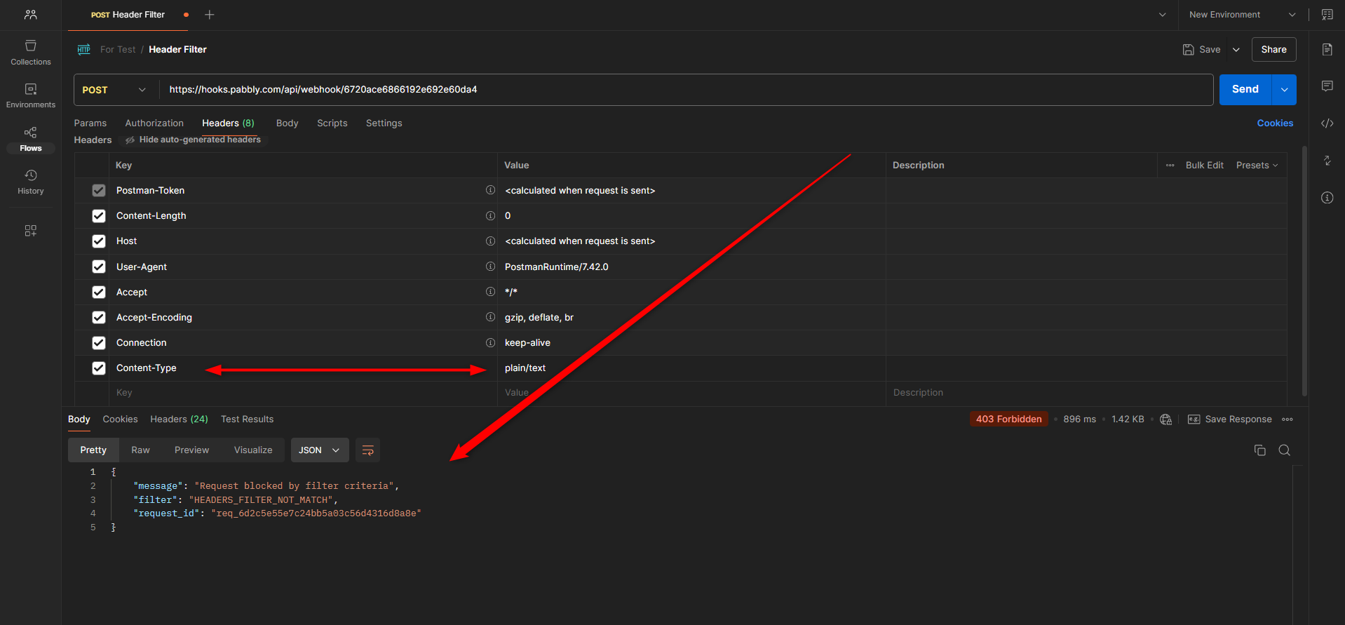

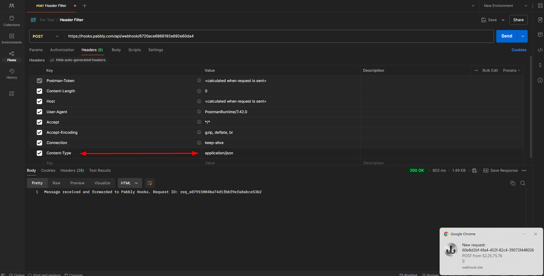

- Example: Header Filtering on Content-Type to process only requests where "Content-Type": "application/json".
- If "Content-Type": "application/json" is not matched it will block the request.
- Example: Filtering on the Content-Type field to process messages with "Content-Type": "plain/text".

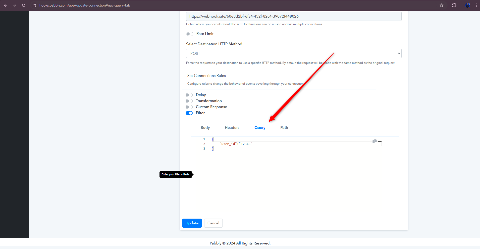

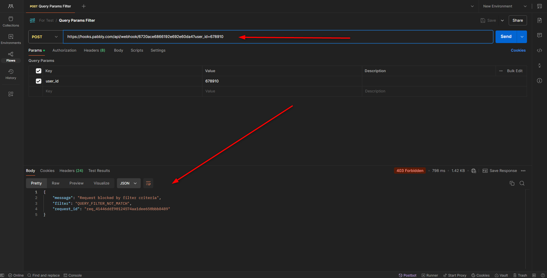

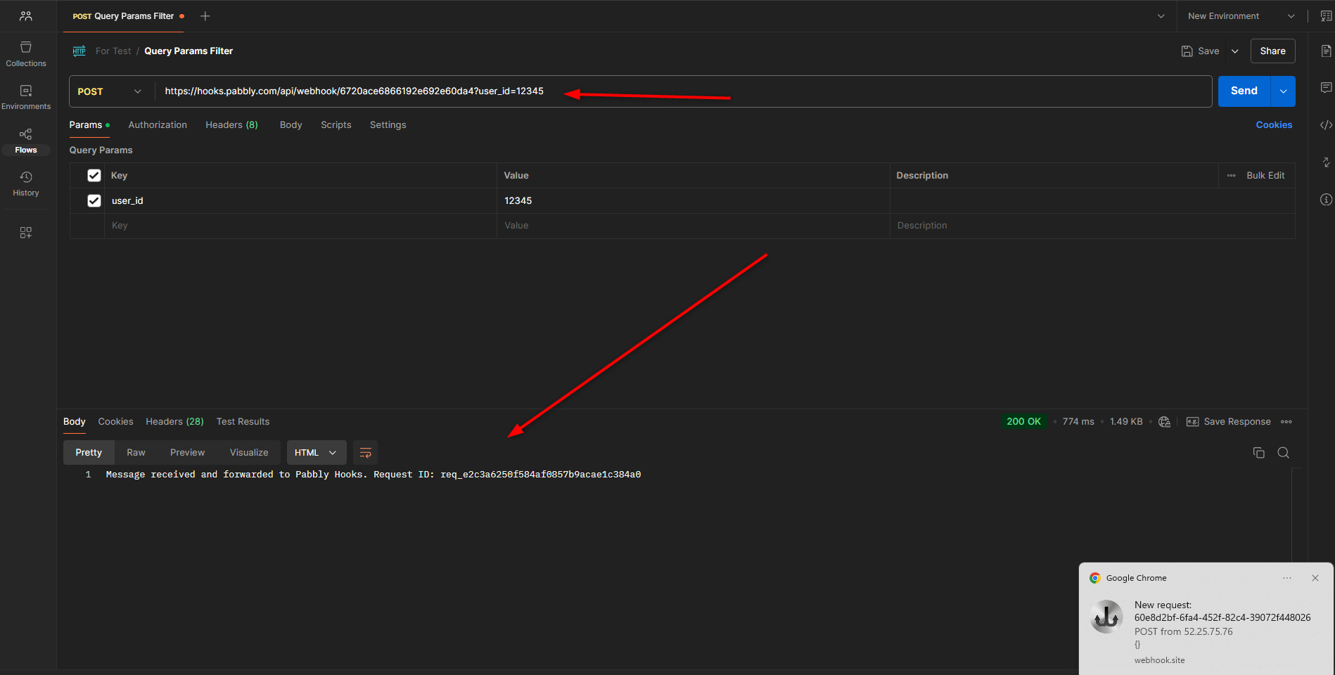

3. Query Filter
A
Query Filter is used to filter requests based on query parameters. This is helpful when specific information, like IDs or action types, is passed as URL query parameters.
- Example: Query Params Filtering on the user_id query parameter to process requests only for a specific user "user_id":"12345".
- If "user_id":"12345" is not matched it will block the request.
- Example: Filtering on the field to process messages with "user_id":"678910".
