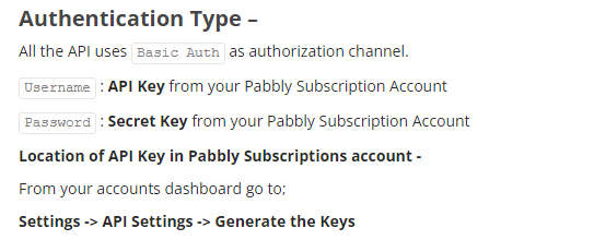

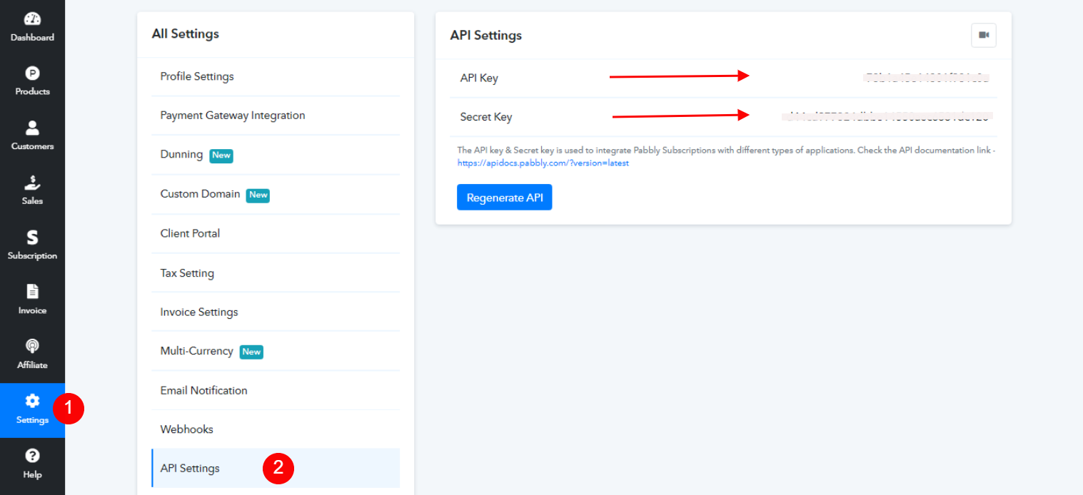

This API uses a POST Method and you must use the basic Authorization keys i.e., API KEY and SECRET KEY in order to get this API to work. To get the authorization keys, go to Settings >> API settings >> Generate the Keys.
Refer to the images given below.
