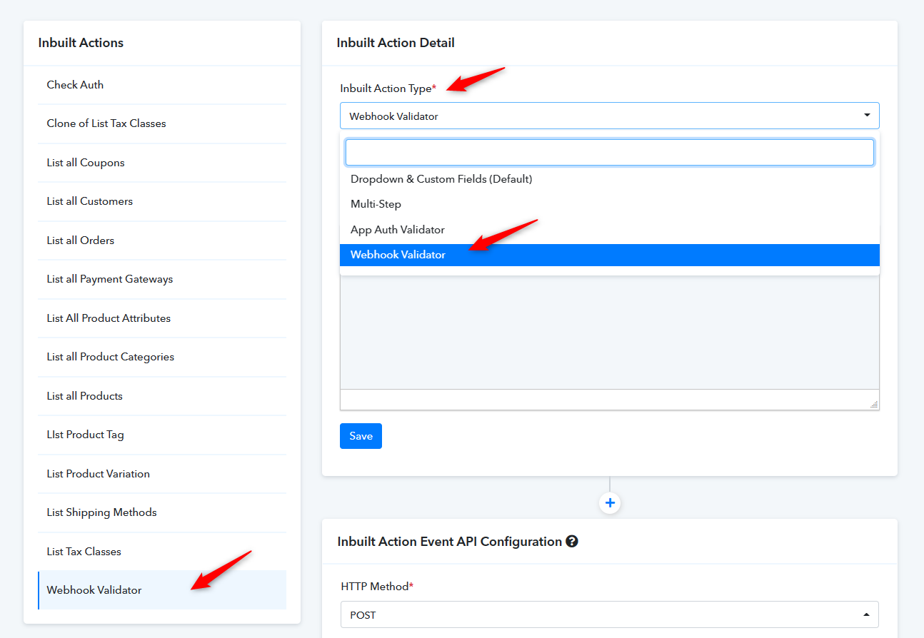

Pabbly Connect allows validating the webhook URL by adding an Inbuilt Action type "Webhook Validator" where, one can define the template JSON in which it is mentioned, which value of the received JSON/Form-Data needs to be processed and returned.
To configure
Webhook Validator in your application. You should follow these steps-
Go to the Inbuilt Action page of your app and create an inbuilt action event with
Webhook Validation inbuilt action event type
In the Webhook Validator Inbuilt Action Event API Configuration, you must pass the below request body JSON and enter "no_url" in the API endpoint URL field leaving as it is other sections.

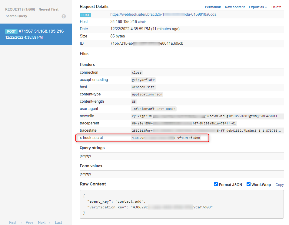

Example 3: Keap
When we need to capture the challenge key in the received header at the webhook URL and return back the same in the response header.
As required in InfusionSoft by Keap documentation here:
Keap sends data on Webhook URL as shown below:
Note: You can also, try webhook.site webhook URL to check the sample data that will the application sends for the validation process and create the JSON payload accordingly.
Our Payload JSON should be:
JSON:
"received_challenge_keys": [
"{{verification_key}}",
"{{received_http_headers==>x-hook-secret}}"
"code": "",
"response_headers": {
"X-Hook-Secret": "{{received_http_headers==>x-hook-secret}}"

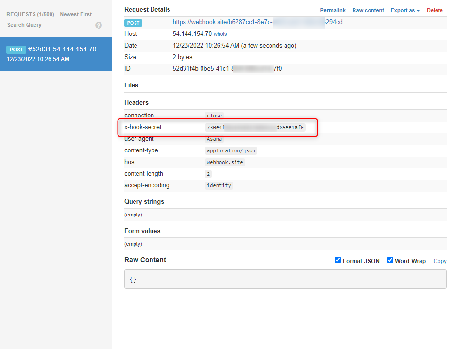

Example 4: Asana
As required in Asana documentation here:
Asana sends data on Webhook URL as shown below:
JSON:
"code": "",

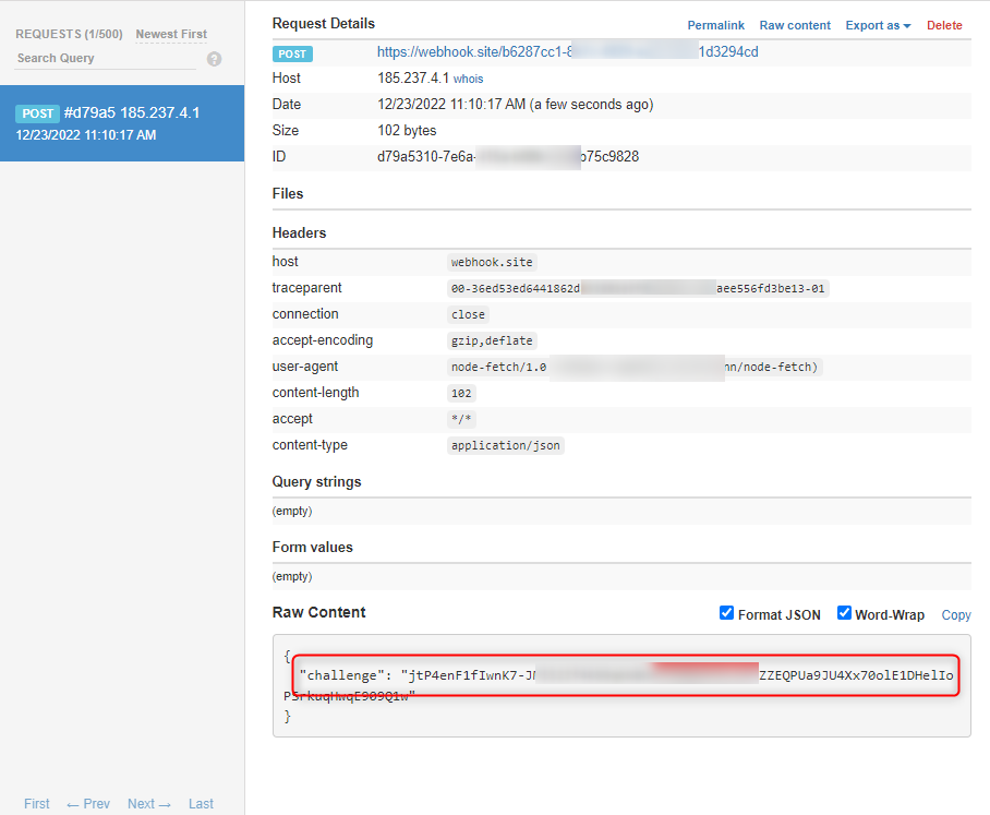

Monday.com
When we need to capture the challenge key in the received payload JSON at the webhook URL and return back the same in the response payload JSON.
As required in monday.com documentation here:
JSON:
"{{challenge}}"
"code": "return { challenge: \"{{challenge}}\" };",
"response_headers": {}

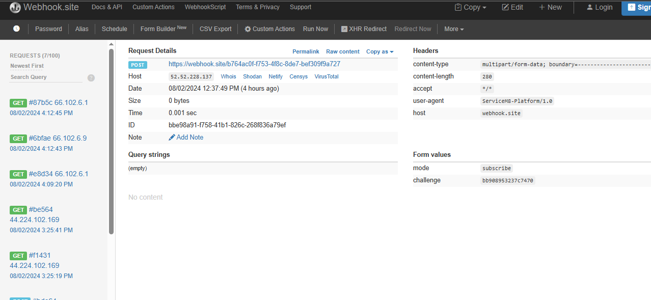

ServiceM8
When we need to capture the challenge key in the received Form Values at the webhook URL and return back the same in the response as palin text.
As required in serviceM8 documentation here:
How to get the received headers keys for processing further in validation.
Suppose, the application is sending the challenge code in form valueswith the key 'challenge' then, you can define it with the following variable in the Validator Inbuilt Action JSON template.
Code:
"{{challenge}}"
"code": "return `{{challenge}}`;",
"content-type": "text/plain"
You can refer to examples #3 or #4 to learn more.
