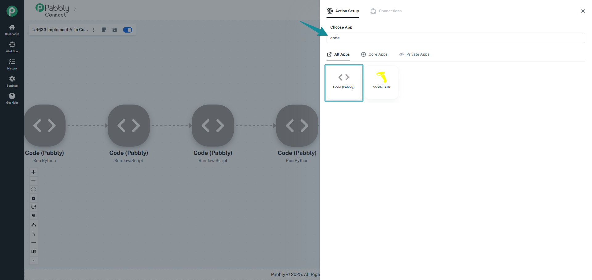

Step 1: Access Code (Pabbly) Module
Navigate to your Pabbly Connect workflow and add a
Code (Pabbly) action step.
Screenshot Reference:
- Search for "code" in the app selector
- Select Code (Pabbly) from the available options

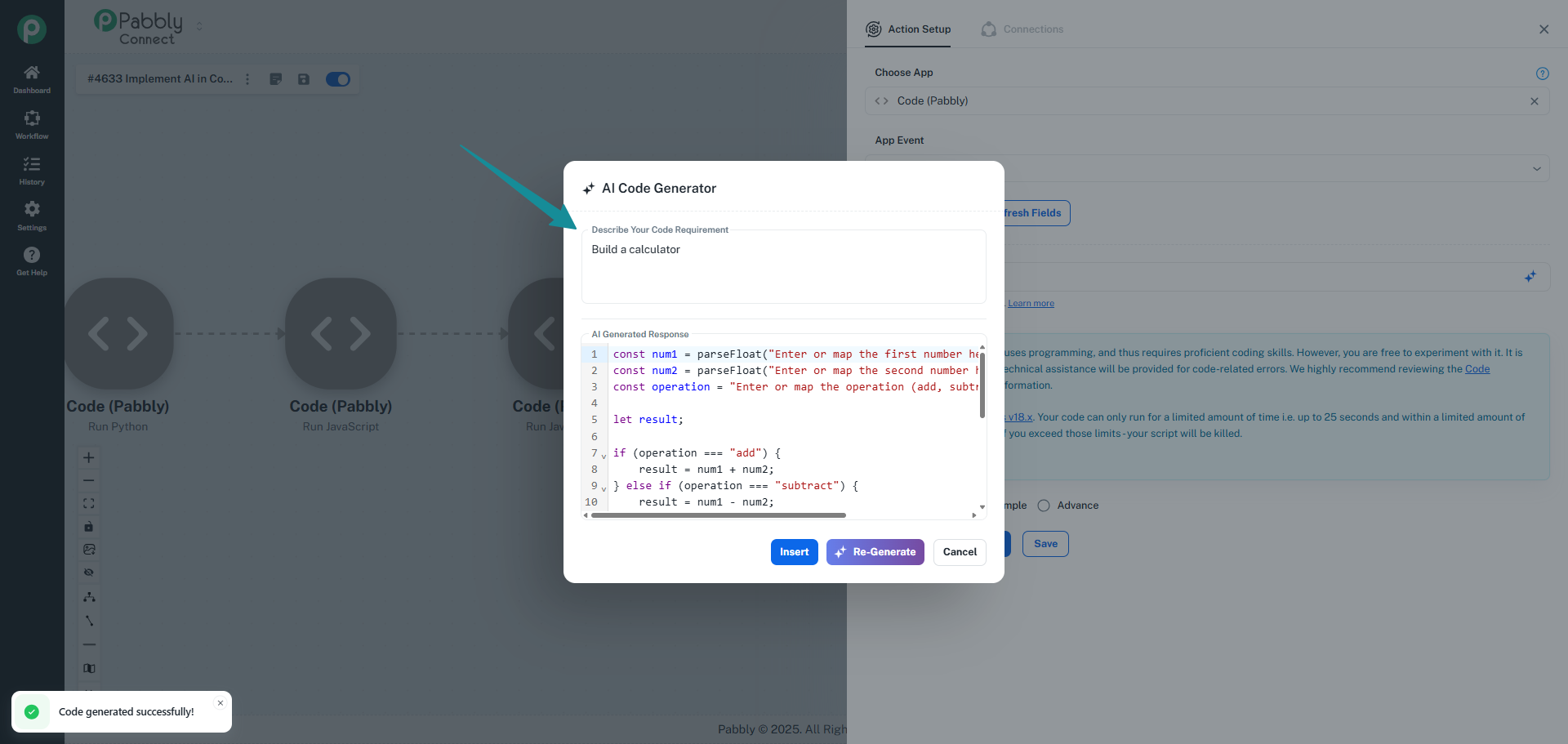

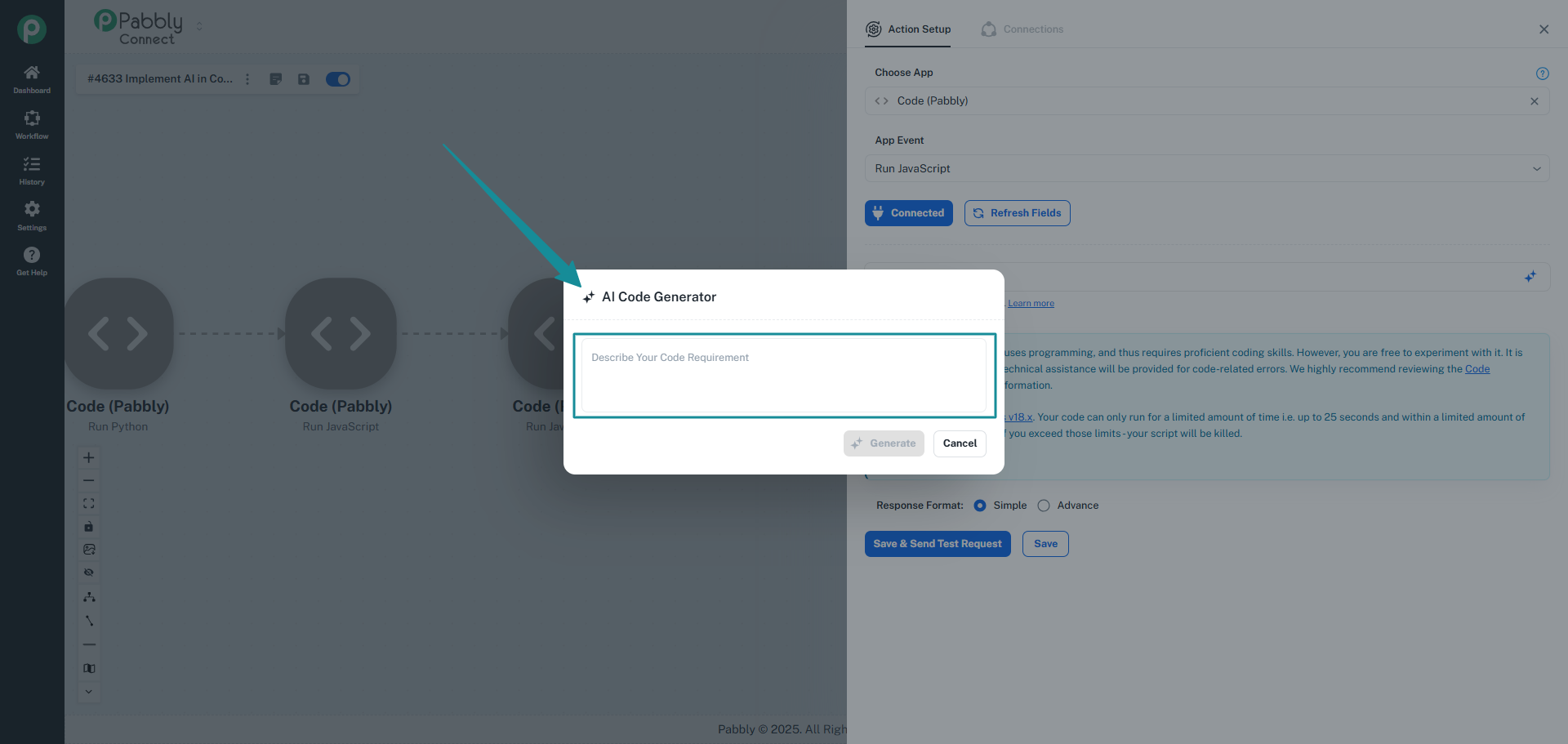

Step 3: Open AI Code Generator

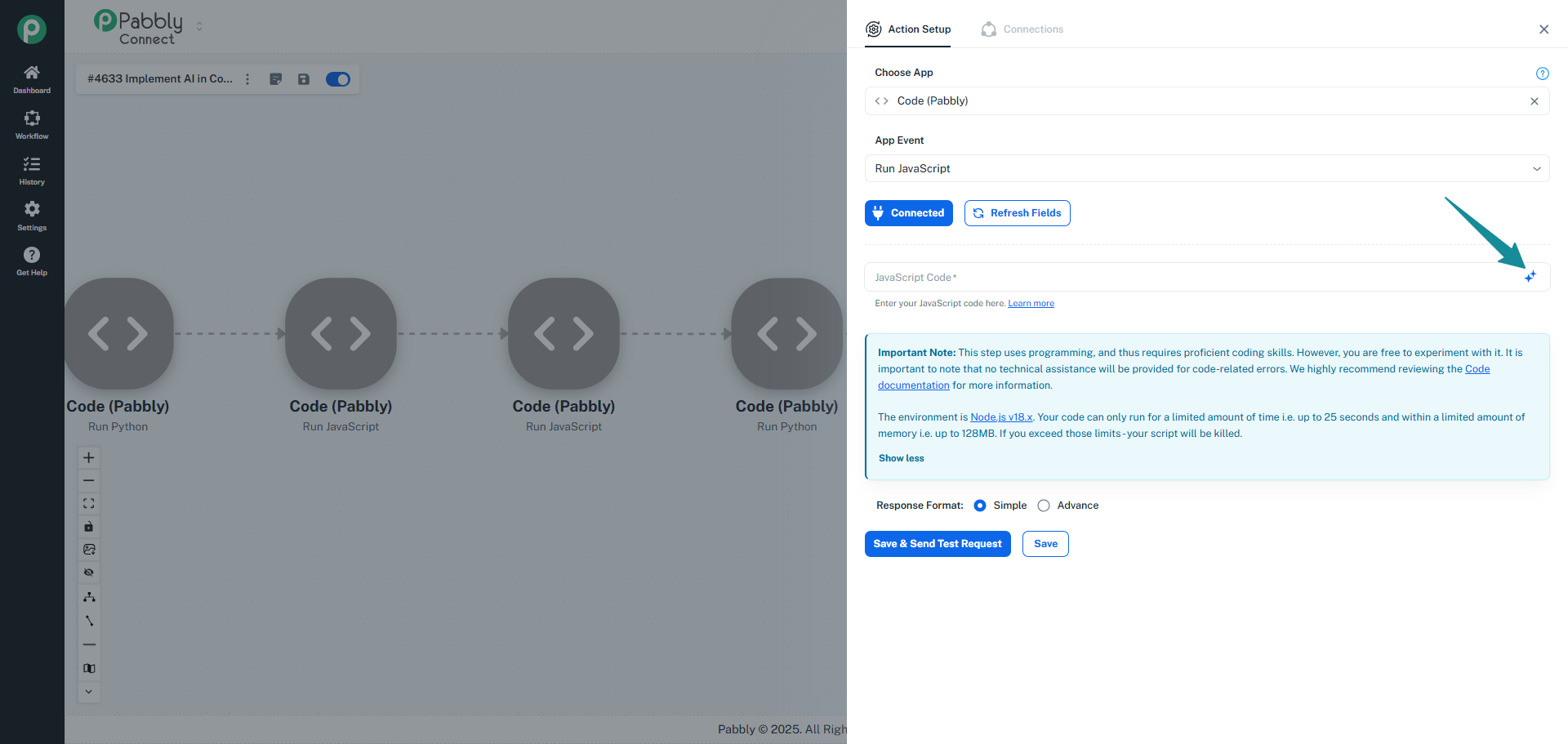

Click the
sparkle icon (✨) in the JavaScript Code field to open the AI Code Generator modal.
- A modal window titled "AI Code Generator" will appear
- You'll see a text area with the placeholder: "Describe Your Code Requirement"
Step 4: Describe Your Code Requirement
Enter a clear description of what you want the code to do in plain English.
- Example: "Build a calculator"
- Click the "Generate" button to create the code
- The AI will process your request and generate JavaScript code

Step 5: Review and Insert Generated Code
Review the AI-generated code and insert it into your workflow.
- The generated code will appear in the modal with line numbers
- Review the code structure and logic
- Three options are available:
- Insert: Add the code to your JavaScript Code field
- Re-Generate: Create a different version if needed
- Cancel: Close without inserting

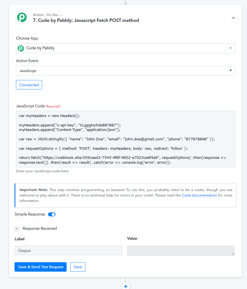

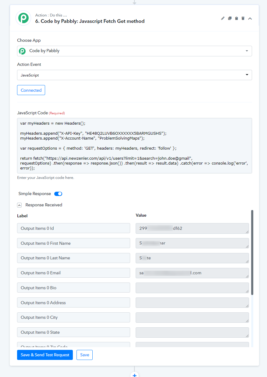

You can extend the functionality of your Pabbly Connect workflow by using the most widely used web programming language,
JavaScript, with
Code by Pabbly : JavaScript action.

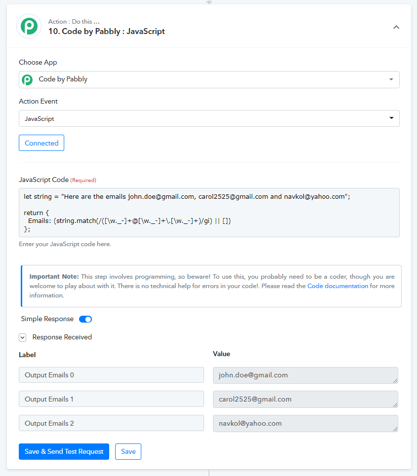

Some of use cases include:
- Date transformations or data type conversions.
- Use custom regular expressions to extract data like emails or tracking numbers from large text blobs.
- Make an extra API call to a different service with fetch without building a full dev app.

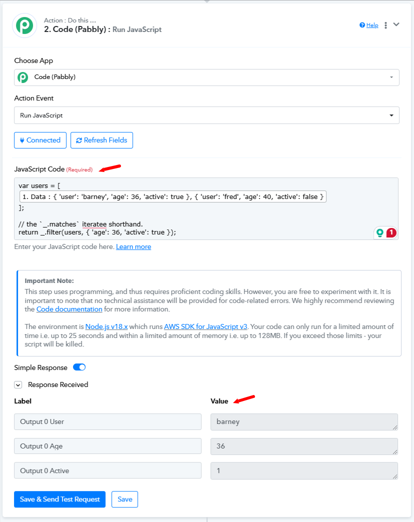

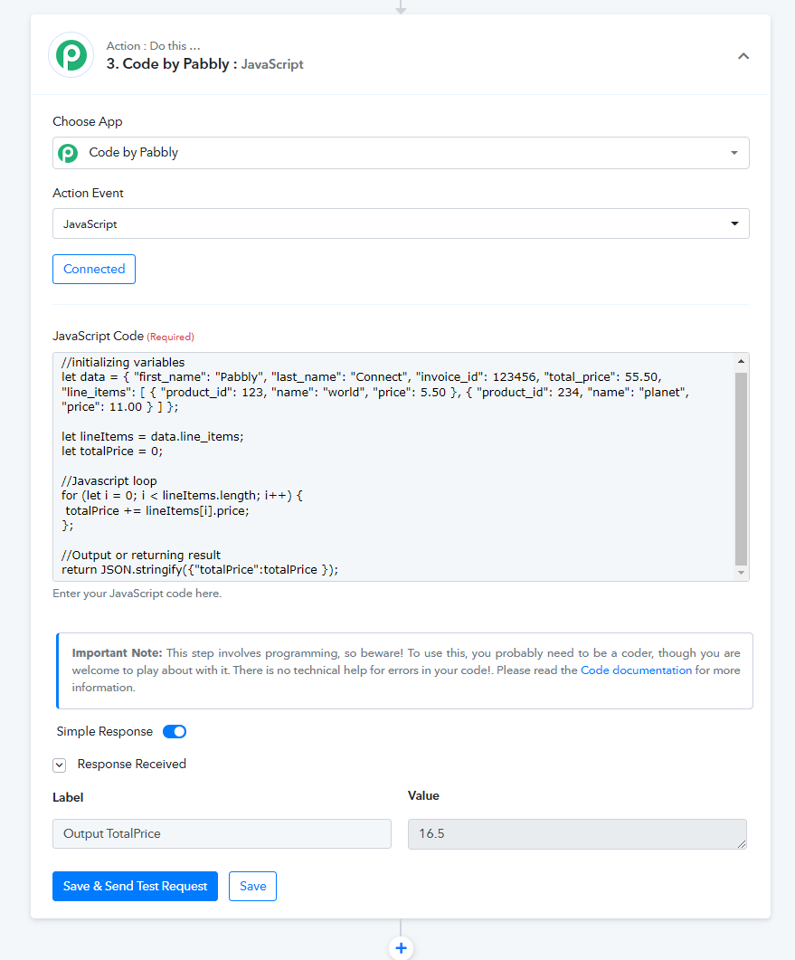

Here is a sample JavaScript code with which, you can get the idea of using variables and performing operations on them to return the desired output.
JavaScript:
//initializing variables
let data = {
"first_name": "Pabbly", "last_name": "Connect", "invoice_id": 123456, "total_price": 55.50, "line_items": [ { "product_id": 123, "name": "world", "price": 5.50 }, { "product_id": 234, "name": "planet", "price": 11.00 } ] };
let lineItems = data.line_items;
let totalPrice = 0;
//Javascript loop
for (let i = 0; i < lineItems.length; i++) {
totalPrice += lineItems[i].price;
//Output or returning result
return JSON.stringify({"totalPrice":totalPrice});

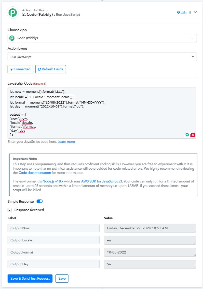

Check the screenshot below of executing the above code:

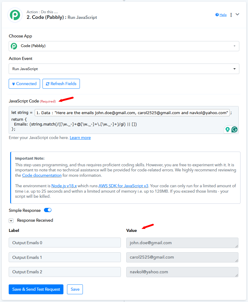

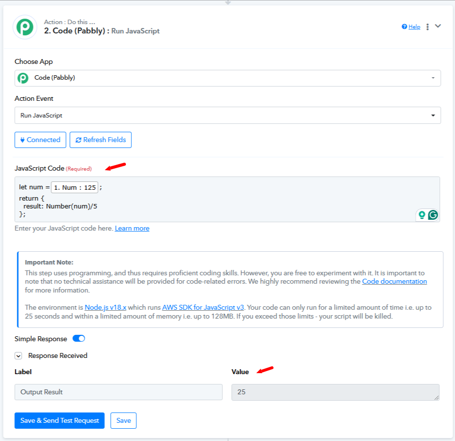

- Using the same structure with mapped fields.

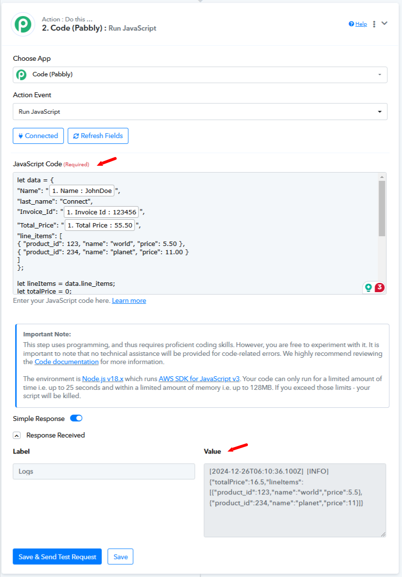

Note: Ensure that the value mapped from the above event adheres to the proper JSON structure, including clearly defined keys and corresponding values.
JavaScript:
let data = {
"Name": "1. Name : JohnDoe",
"Invoice_Id": "1. Invoice Id : 123456",
"Total_Price": "1. Total Price : 55.50",
"line_items": [
let totalPrice = 0;
// JavaScript loop
// Output or returning result
let result = {
totalPrice: totalPrice,
lineItems: lineItems
console.log(JSON.stringify(result));

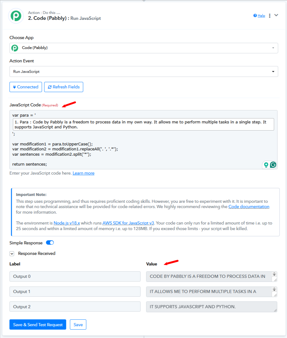

Section 2.
Return a value: obtain the final output/result of the execution
The returned a value will be available under the label Output in the step Response.
You have two ways to return your required value - using a return statement, using the
output variable instead of a return statement. Follow any one of them, as demonstrated below.
2.1. Using a return statement:
JavaScript:
// Convert a given paragraph to uppercase and then extract sentences from it:-
var para = 'Code by Pabbly is a freedom to process data in my own way. It allows me to perform multiple tasks in a single step. It supports JavaScript and Python.';
var modification1 = para.toUpperCase();
var modification2 = modification1.replaceAll('. ', '.*');
var sentences = modification2.split('*');
return sentences;

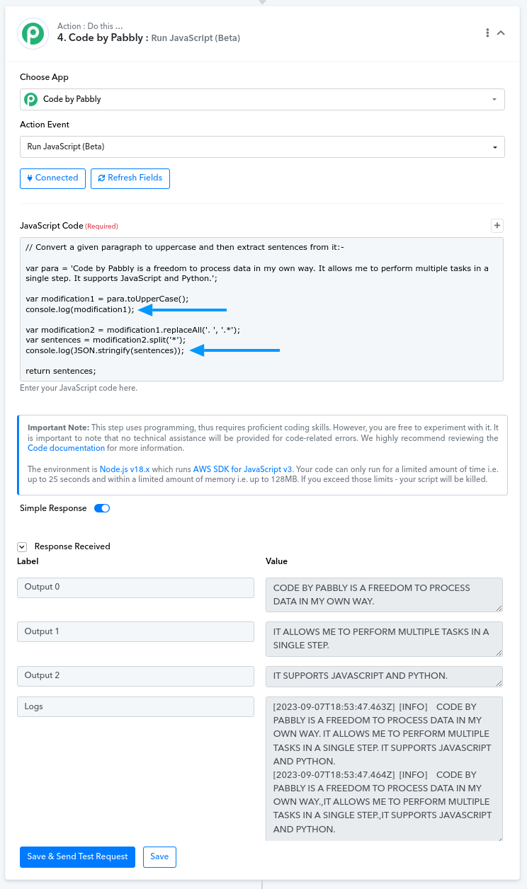

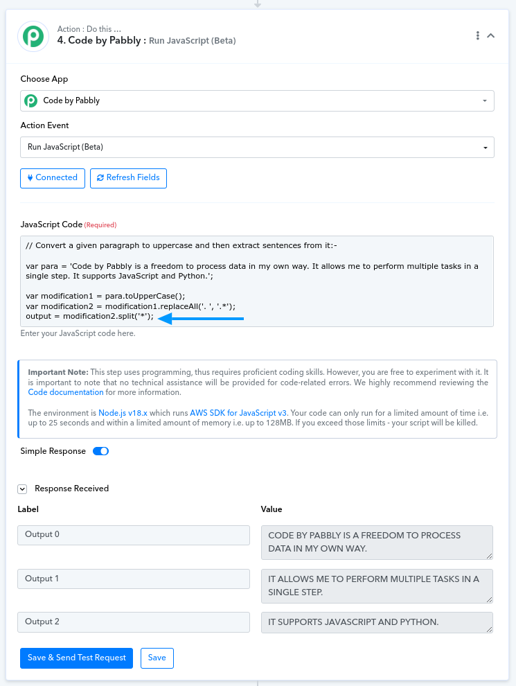

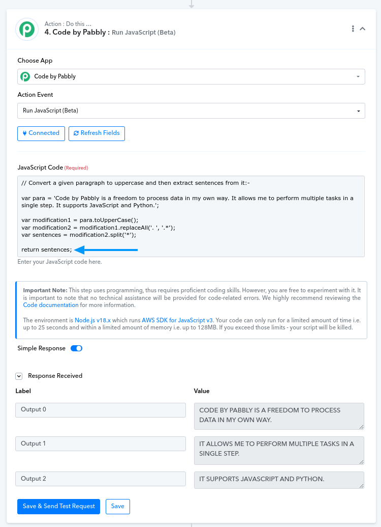

2.2. Using the output variable instead of a return statement:
Assign your required value to our pre-declared variable output. The last assigned value of output will be returned as your execution result.
JavaScript:
output = modification2.split('*');
Notice that the outcome (the step Response) is the same.

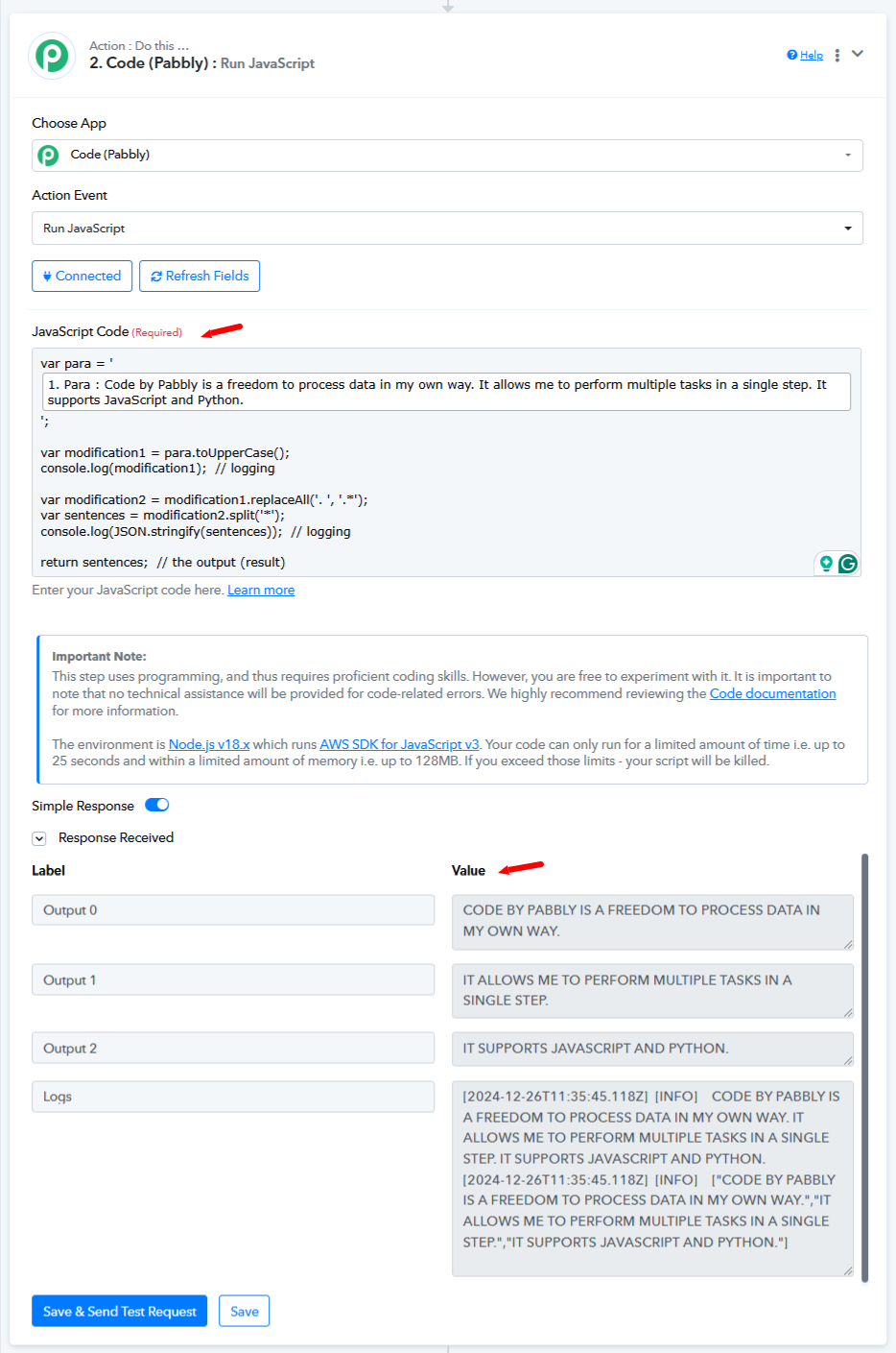

Logging is optional. In order to check (print) intermediate values of the execution, you can use the following console methods:
log(),
error(),
warn(), and
debug().
All the printings by these methods will be visible under the label Logs in the step Response.
JavaScript:
console.log(modification1); // logging
console.log(JSON.stringify(sentences)); // logging
return sentences; // the output (result)
Tip:
To print an array or object, stringify it first.
JavaScript:
Note: Ensure that the value mapped from the above event adheres to the proper code structure, including clearly defined keys and corresponding values.
Important:
Logging option is not for obtaining the final output of the workflow step. To obtain the final output follow Section 2 above.
Section 4.

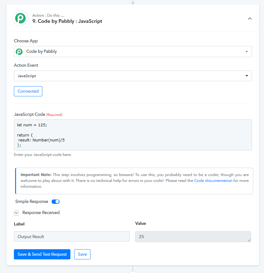

Example: Mathematical Expression - divide by five
JavaScript:
let num = 125;
return {
result: Number(num)/5

Example: Using Regex to extract emails from given string

Example: Use fetch()
The Fetch API provides a JavaScript interface for accessing and manipulating parts of the protocol, such as requests and responses. It also provides a global fetch() method that provides an easy, logical way to fetch resources asynchronously across the network.
GET API Call Example
JavaScript:
//Defining headers
var myHeaders = new Headers();
//Initializing header with required values like, API Key, Content type etc.
myHeaders.append("X-API-Key", "HE48Q2LUVB6OXXXXXX5BARMGUSHS");
myHeaders.append("X-Account-Name", "MyAccount");
var requestOptions = {
method: 'GET',
headers: myHeaders,
redirect: 'follow'
//Return statement with fetch function
return fetch("https://api.newzenler.com/api/v1/users?limit=1&search=john.doe@gmail",
requestOptions) .then(response => response.json()) .then(result => result.data) .catch(error => console.log('error', error));
POST API Call Example
JavaScript:
//Defining headers
//Pass specific headers if required like, API Key, Token, Content Type etc..
myHeaders.append("x-api-key", "XLgggHyhde887887");
myHeaders.append("Content-Type", "application/json");
//API request body JSON payload
var raw = JSON.stringify({
"name": "John Doe",
"email": "[email protected]",
"phone": "877878898"
method: 'POST',
headers: myHeaders,
body: raw, redirect: 'follow'
return fetch("https://webhook.site/059ceed3-7545-4f8f-9852-e7023ce6f4a9", requestOptions) .then(response => response.text()) .then(result => result) .catch(error => console.log('error', error));

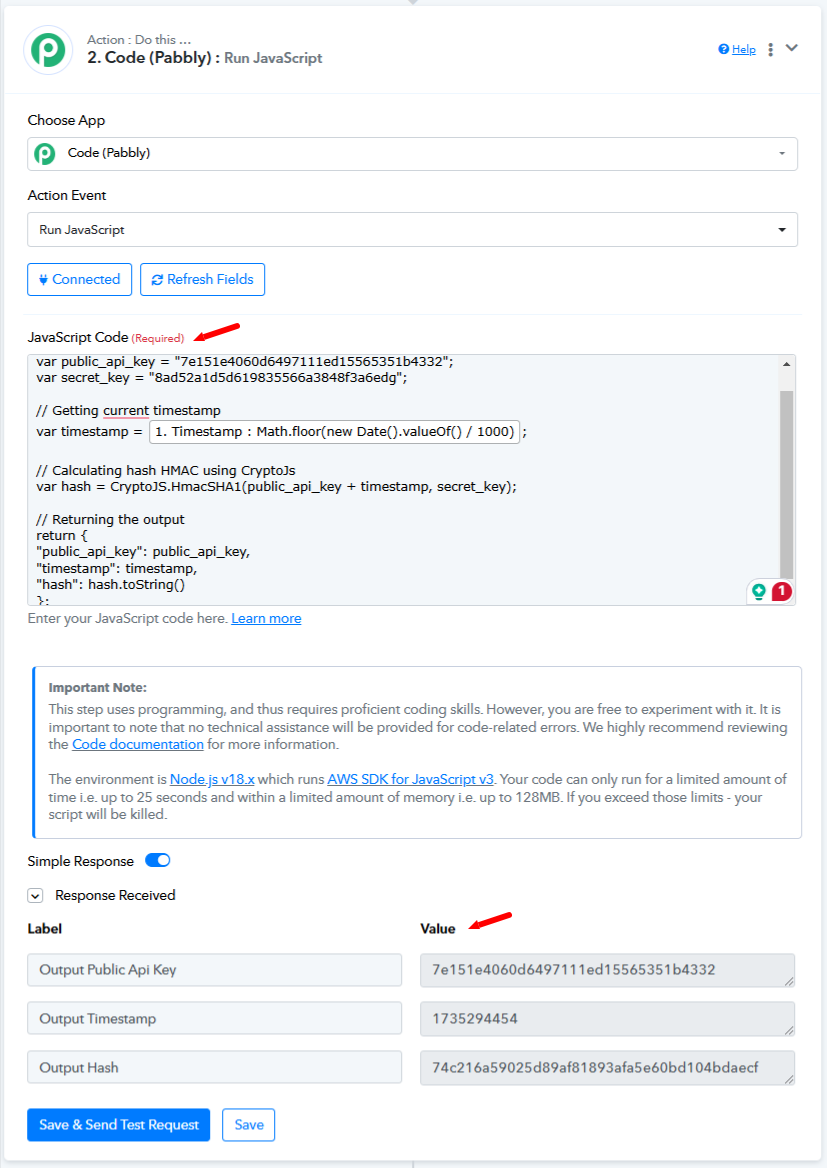

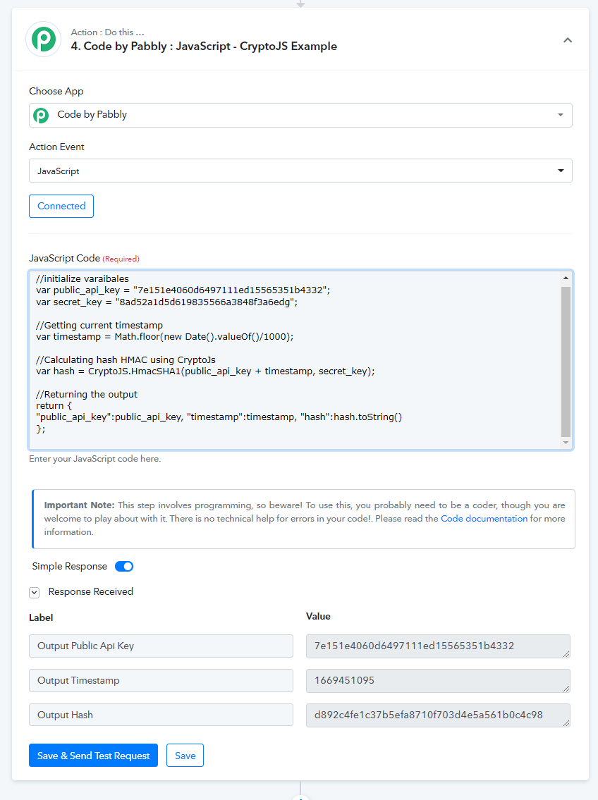

CryptoJS is a growing collection of standard and secure cryptographic algorithms like, MDF, SHA1, SHA2, AES, HMAC, etc. implemented in JavaScript using best practices and patterns.
JavaScript:
//initialize varaibales
var public_api_key = "7e151e4060d6497111ed15565351b4332";
var secret_key = "8ad52a1d5d619835566a3848f3a6edg";
//Getting current timestamp
var timestamp = Math.floor(new Date().valueOf()/1000);
//Calculating hash HMAC using CryptoJs
var hash = CryptoJS.HmacSHA1(public_api_key + timestamp, secret_key);
//Returning the output
return {
"public_api_key":public_api_key, "timestamp":timestamp, "hash":hash.toString()

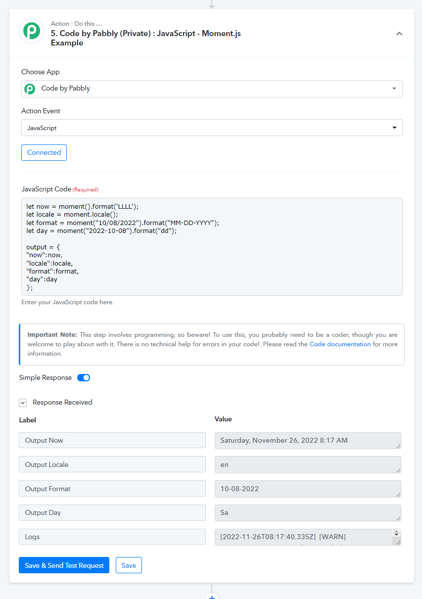

A JavaScript date library for parsing, validating, manipulating, and formatting dates.
JavaScript:
let now = moment().format('LLLL');
let locale = moment.locale();
let format = moment("10/08/2022").format("MM-DD-YYYY");
let day = moment("2022-10-08").format("dd");
output = {
"now":now,
"locale":locale,
"format":format,
"day":day

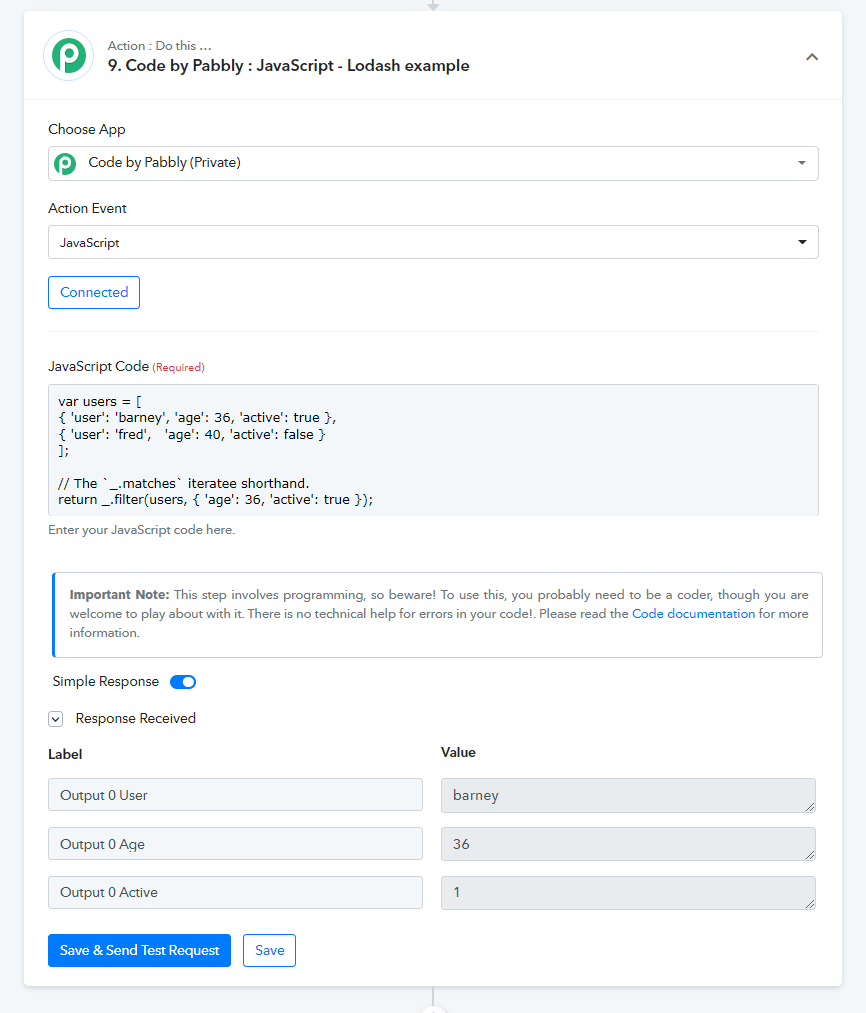

Lodash is a JavaScript library that works on the top of underscore.js. It helps in working with arrays, strings, objects, numbers, etc. It provides us with various inbuilt functions and uses a functional programming approach which that coding in JavaScript easier to understand because instead of writing repetitive functions, tasks can be accomplished with a single line of code.
JavaScript:
var users = [
{ 'user': 'barney', 'age': 36, 'active': true },
{ 'user': 'fred', 'age': 40, 'active': false }
// the `_.matches` iteratee shorthand.
return _.filter(users, { 'age': 36, 'active': true });
