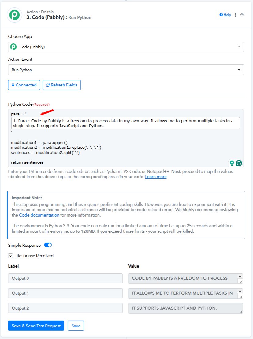

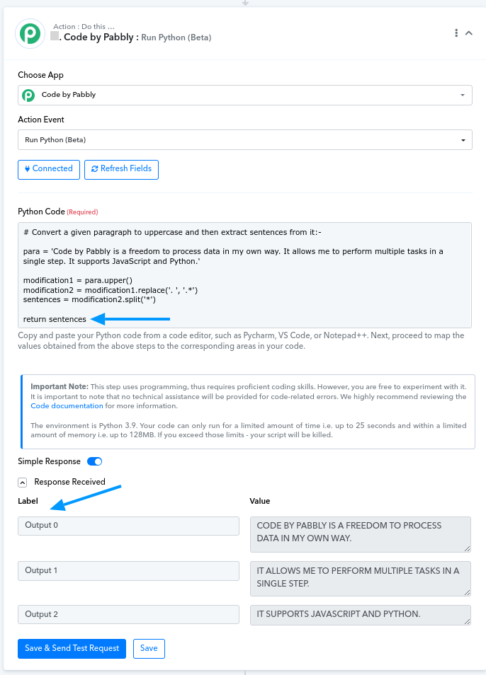

2.1. Using a return statement:
Python:
# Convert a given paragraph to uppercase and then extract sentences from it:-
para = 'Code by Pabbly is a freedom to process data in my own way. It allows me to perform multiple tasks in a single step. It supports JavaScript and Python.'
modification1 = para.upper()
modification2 = modification1.replace('. ', '.*')
sentences = modification2.split('*')
return sentences
Note: Ensure that the value mapped from the above event adheres to the proper code structure, including clearly defined keys and corresponding values.

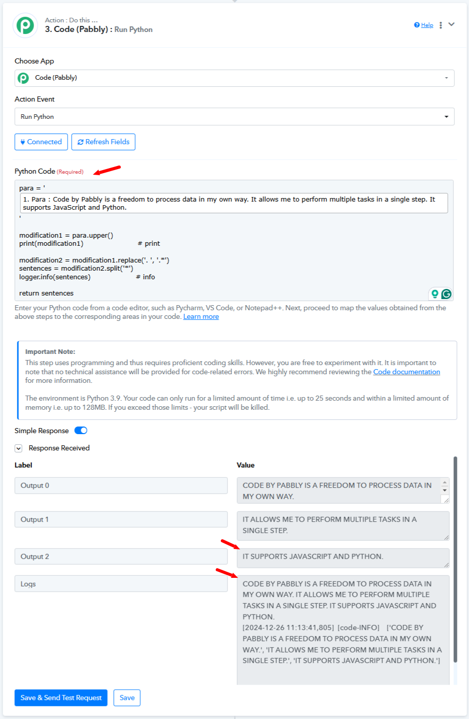

Python:
para = '1. Para : Code by Pabbly is a freedom to process data in my own way. It allows me to perform multiple tasks in a single step. It supports JavaScript and Python.'
return sentences
Check the screenshot below of executing the above code:

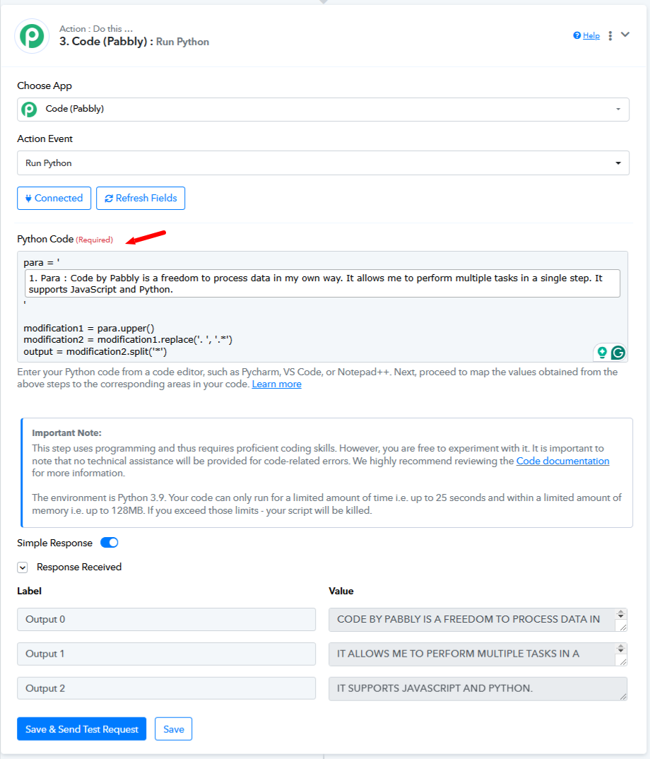

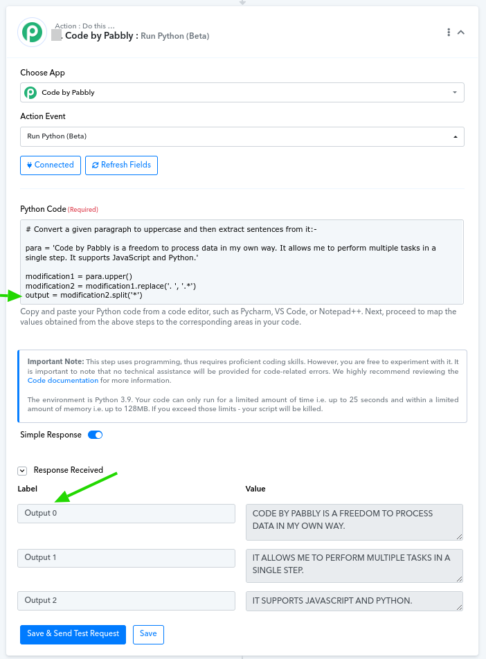

2.2. Using the output variable instead of a return statement:
Assign your required value to our predefined variable output. The last assigned value of output will be returned as your execution result.
Python:
output = modification2.split('*')
Notice that the outcome (the step Response) is the same.

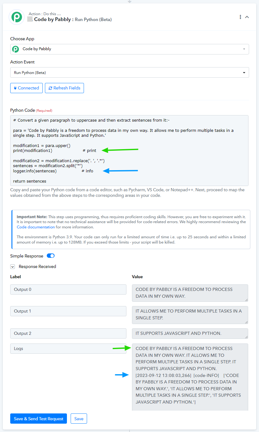

Logging is optional. In order to check (print) intermediate values of the execution, you can use either
print() function or the already named
logger (labeled as
'code').
All the printings will be visible under the label Logs in the step Response.
Python:
print(modification1) # print
logger.info(sentences) # info
return sentences

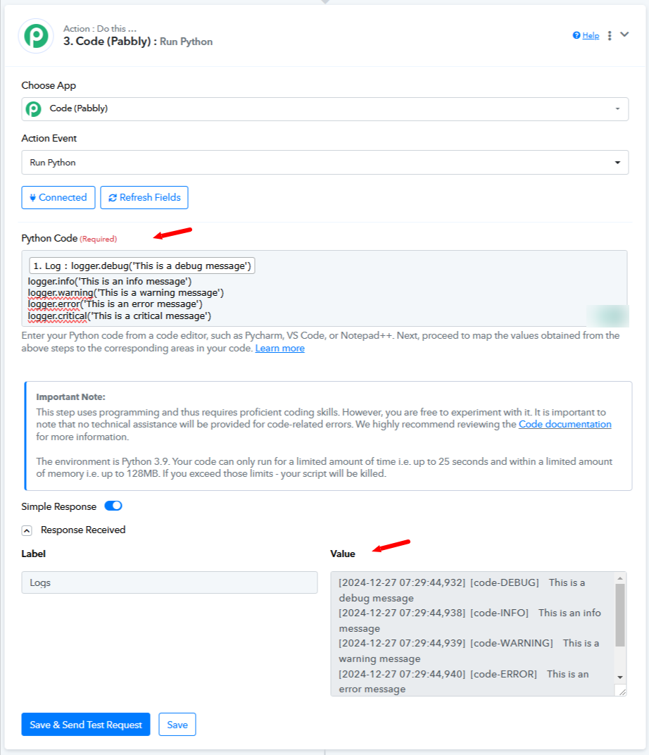

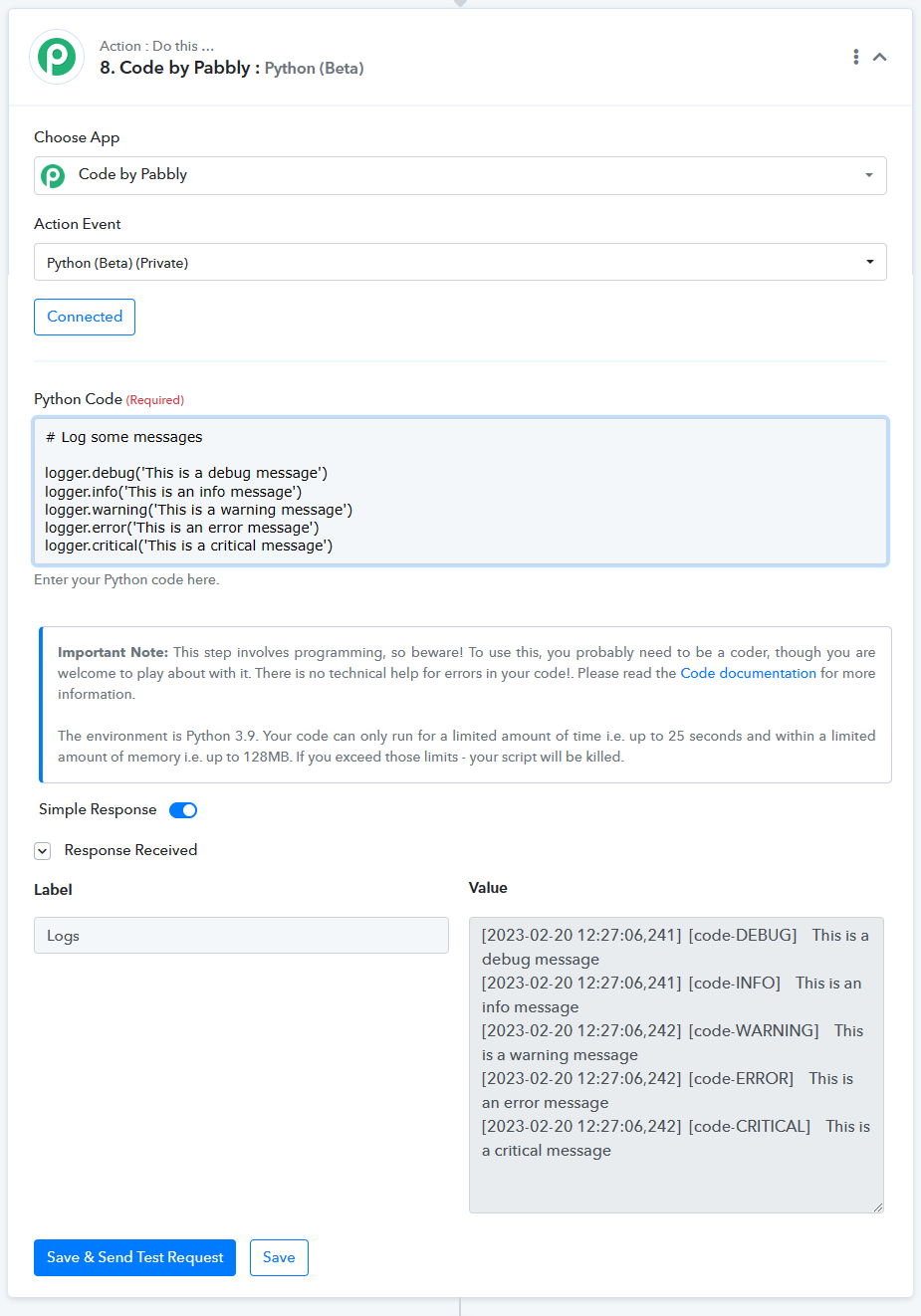

4.3. logging
As mentioned earlier, internally we've imported the logging module and defined a named logger for your convenience. We've named (labeled) the logger as 'code'. So, just directly call the logger methods.
Python:
# Log some messages
logger.debug('This is a debug message')
logger.info('This is an info message')
logger.warning('This is a warning message')
logger.error('This is an error message')
logger.critical('This is a critical message')

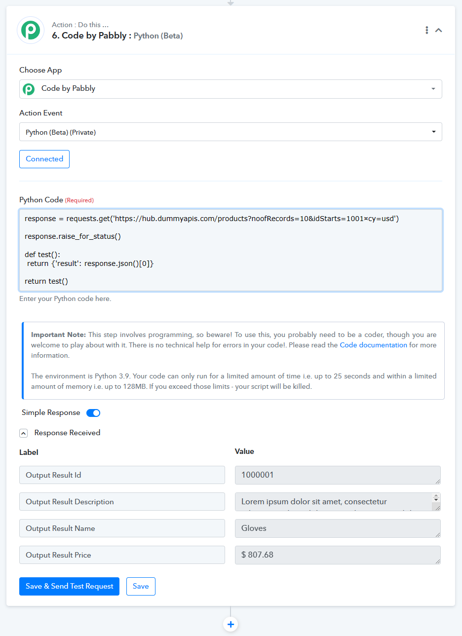

4.4. requests
To easily make HTTP requests we have imported a third-party module, namely requests. Here's an example of how to make a GET request:
Python:
response = requests.get('https://hub.dummyapis.com/products?noofRecords=10&idStarts=1001¤cy=usd')
response.raise_for_status()
def test():
return {'result': response.json()[0]}
return test()

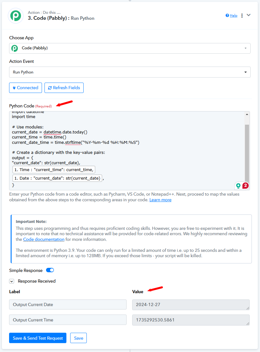

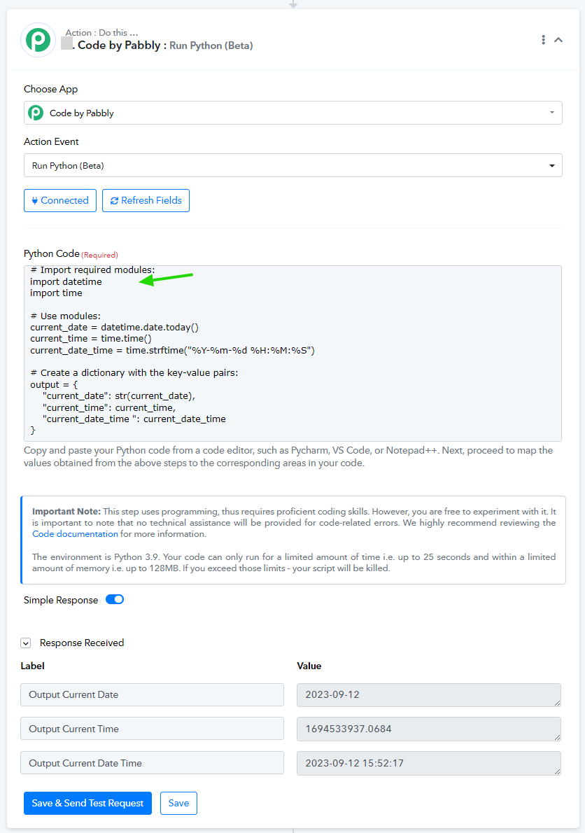

5.1. Example: Importing modules
Python:
# Import required modules:
import datetime
import time
# Use modules:
current_date = datetime.date.today()
current_time = time.time()
current_date_time = time.strftime("%Y-%m-%d %H:%M:%S")
# Create a dictionary with the key-value pairs:
output = {
"current_date": str(current_date),
"current_time": current_time,
"current_date_time ": current_date_time
