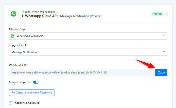

1. Create a Workflow in Pabbly Connect then select WhatsApp Cloud API and within the trigger section choose "Message Notification".
2. Click the copy button, It will be copied to the clipboard and your workflow starts listening for the data.

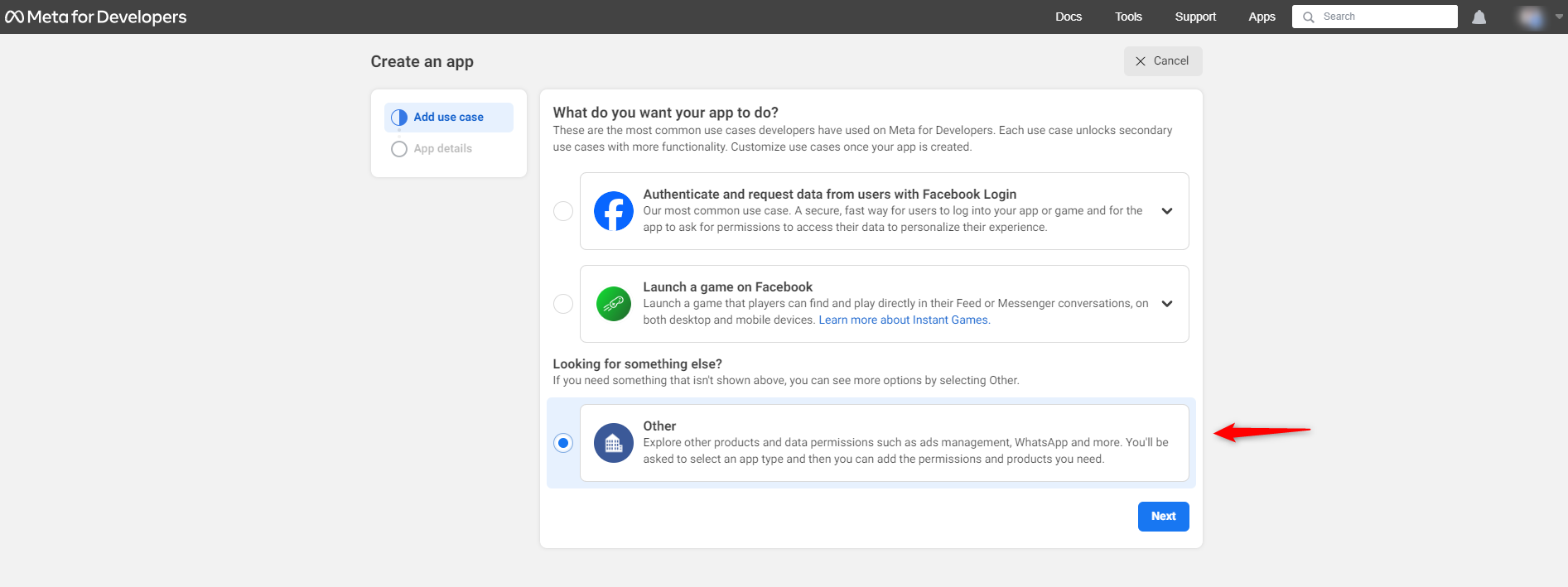

3. Visit your developer dashboard and navigate to the "Create App" option. Within the "Create an App" section, opt for "Other" and then select "Business."

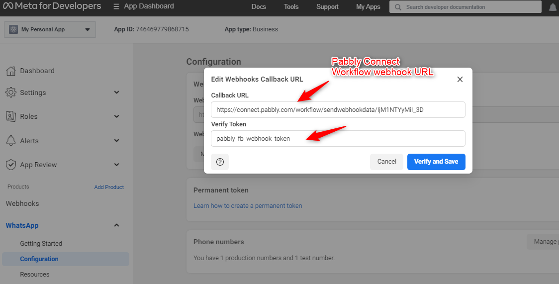

If you have a setup application then find the WhatsApp product and click Configuration. Then, find the webhooks section on the left and click Configure a webhook. After the click, a dialog appears on your screen and asks you for two items:
Callback URL: Paste the webhook URL copied from step 2.
Verify Token: Enter pabbly_fb_webhook_token in this field.
After adding the information, click Verify and Save.

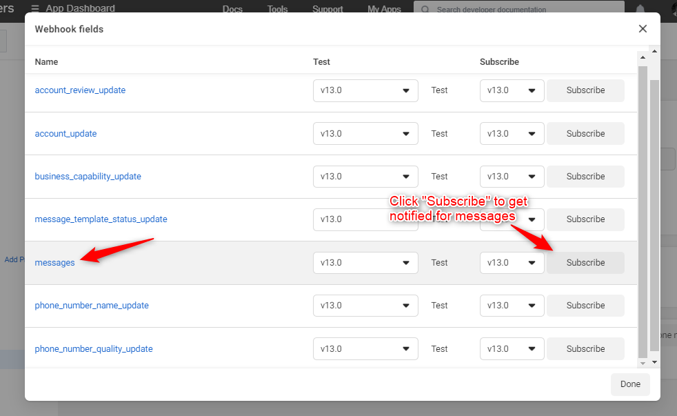

Back in the App Dashboard, click WhatsApp > Configuration in the left-side panel. Under Webhooks, click Manage. A dialog box will open with all the objects you can get notified about. To receive messages from your users, click Subscribe for messages as shown below:

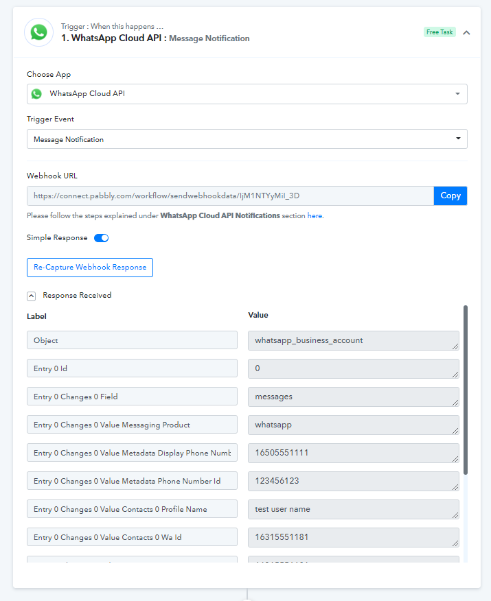

Once you subscribe to the messages event, you can hit the Test button to get the test data captured in your workflow.

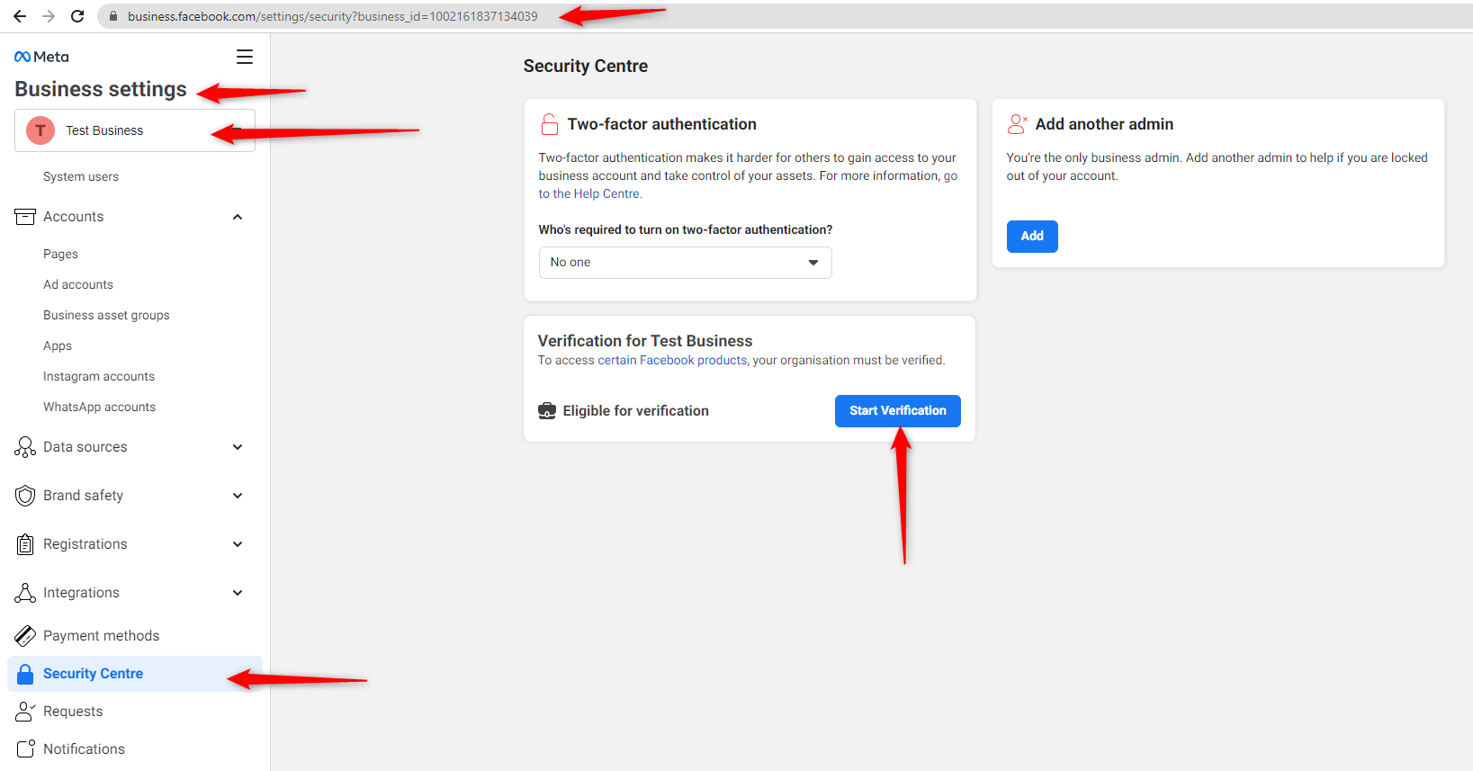

How to get my business verified to increase my limits?
Business verification allows you to get increased sending limits. Without verification, you can send messages to up to 50 unique numbers per day. After verification, the limit increases to sending messages to 1000 unique numbers per day.
You can read more details to get your business verified here.
